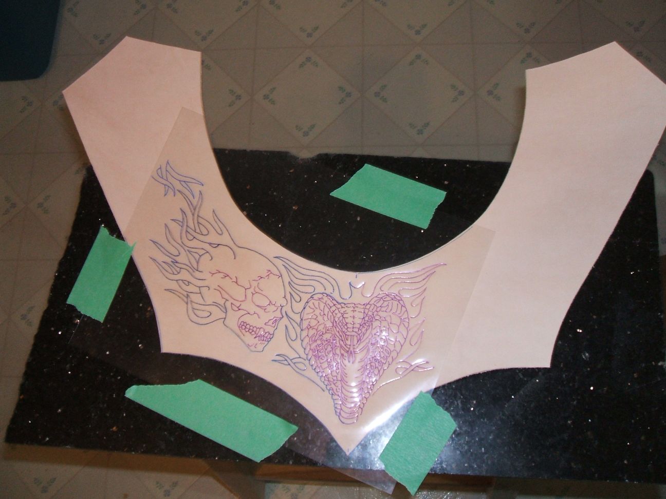

Well first off what I do, is I layout the drawing that I am going to be carving into the shoulder piece. As shown in the pictures, you can see that I use 3 pieces of 3M Transparancy Films for this. I will draw what I'm looking for on regular paper in pencil, this way I can erase and make changes as needed. Then I will trace the final design onto the transparancy film, making sure that I put marks on it so that I know where exactly it sits on the leather shoulder piece.

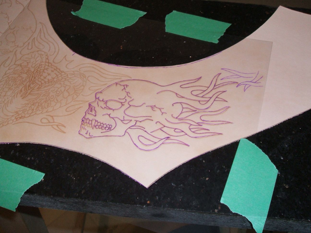

Now, using the stylus, I'll transfer the design into the leather. I will not case the leather like a lot of you do, I will just use the spray bottle and wet the area that is going to be worked on. Once the design is completely transfered onto the leather, I will check to make sure that I haven't missed any of the drawing. I once made a matching pair of mens and ladies vest, and on the one Eagle on the mans vest, I missed the bottom half of the Eagles beak. I never noticed this until the vest was complete...DUH...

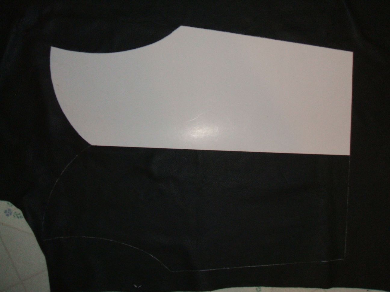

The layout drawing

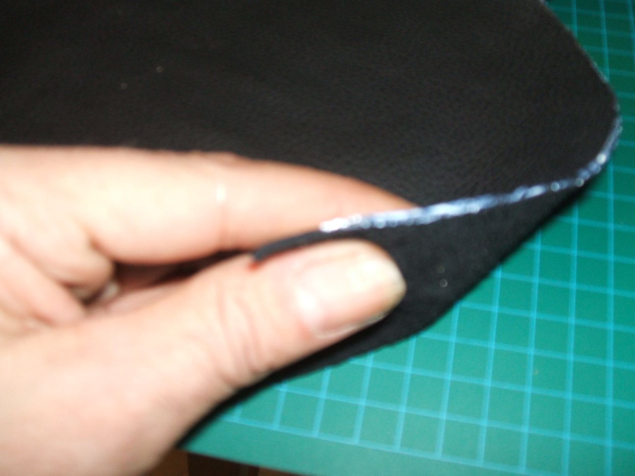

The cut leather

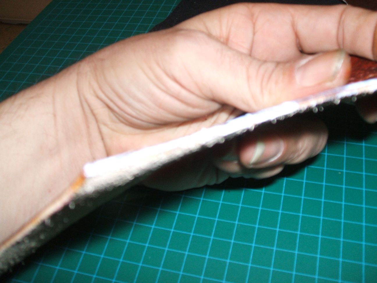

Laying out the design

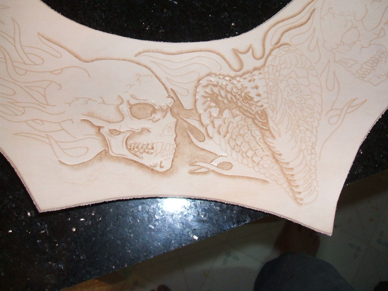

The deisgn scribed onto leather
Starting to carve
