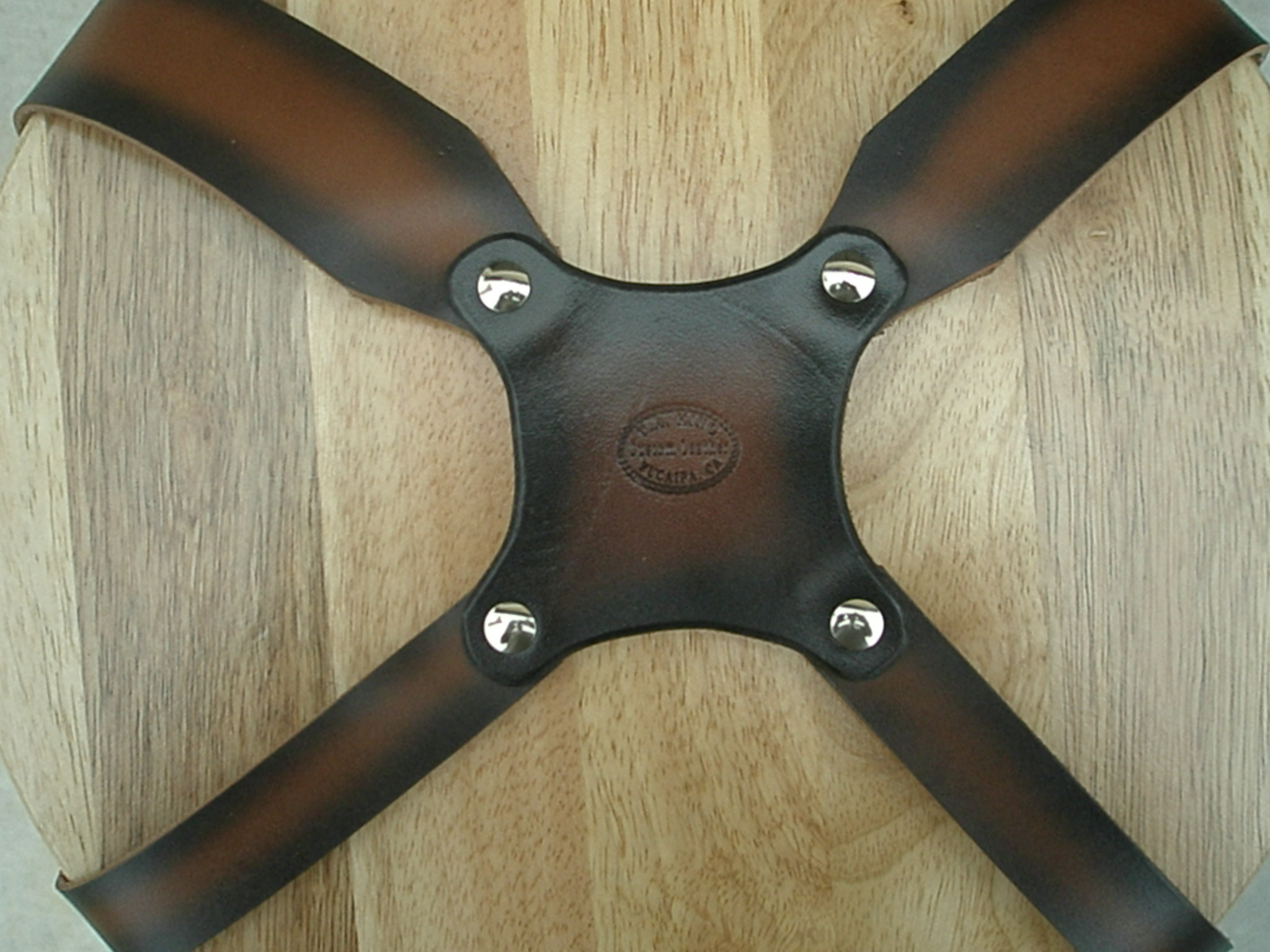

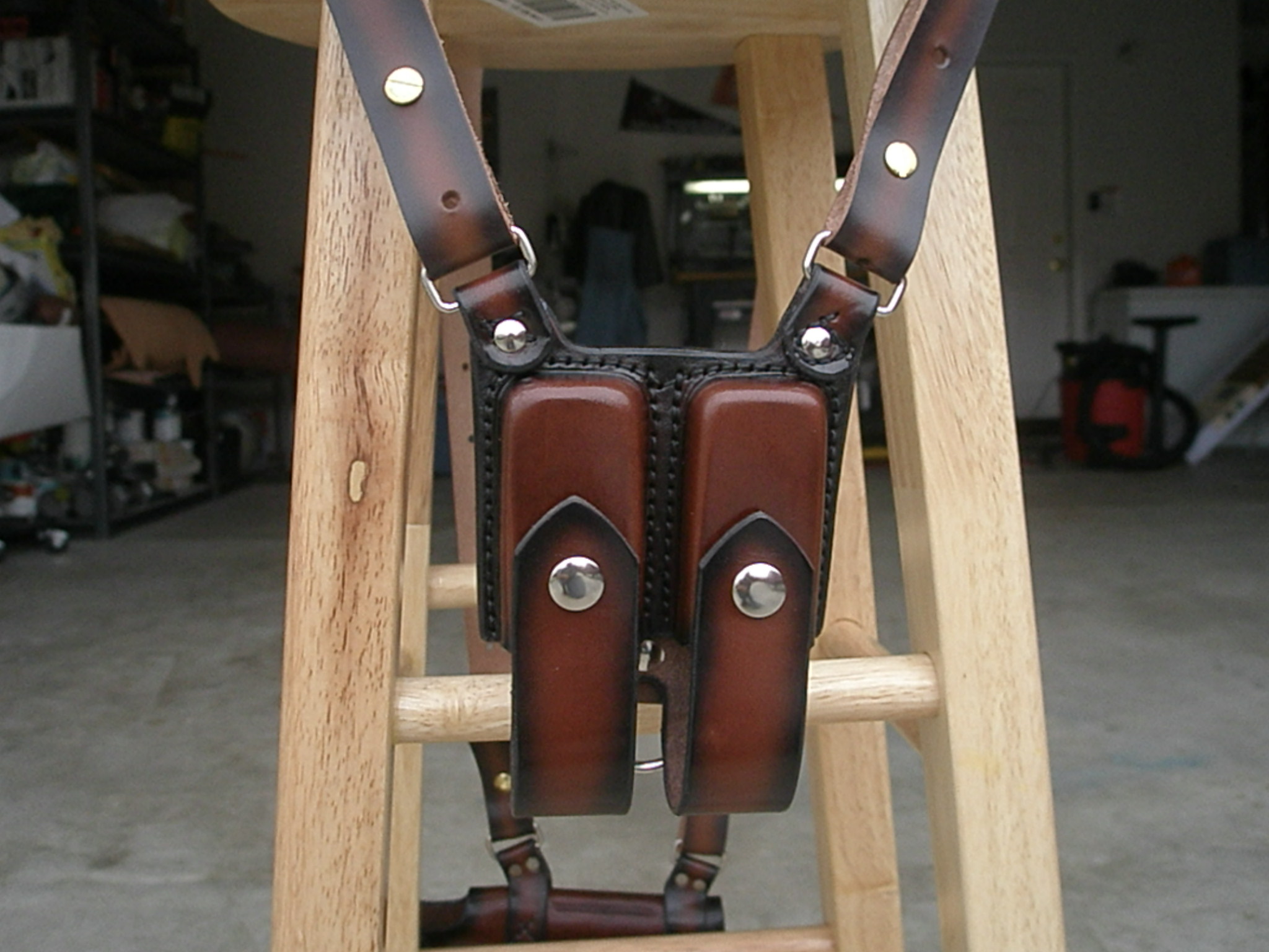

thank you very much Reaper. i wish i could figure how to make the pics smaller. they are so big you have to pan all over to see them all. Tony
well after putting off doing one out of fear, a coworker got me an order for three from one customer. so i had to bite the bullet and do it. glad i did now. this is one of the three that i did. all for different guns. this one is for a 1911, the others were a black one for a beretta 92 and a russett one for a glock. the other two got delivered before i got pics. this one will be delivered tommorrow. got to give thanks to JBIRD for the idea of airbrushing. still not up to his standard but im working on it. Tony
