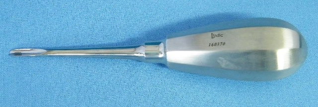

I have just bought a tool which works very well as a lifter (propetal). It is actually a dental elevator for loosening teeth for extraction. It comes in 2 sizes - 4mm and 2mm tips, is made of stainless steel and fits comfortably in the hand. I found it thru ebay Austalia and costs $10 new! http://cgi.ebay.com.au/Dental-Elevator-4mm-Tip-Quality-Instrument-/110654539539?pt=AU_Business_Industrial_Medical_Scientific_Equipment2&hash=item19c3864713

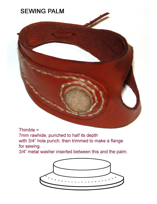

I am continuing to add to my tools on a budget, so I made up a sewing palm. The palm body is 1.5mm semi stiff scrap leather, but I had to put on my thinking cap re the thimble - an offcut of 7mm rawhide looked promising. I used a 3/4'' hole punch to penetrate half it's thickness, then cut into this to form a flange for sewing onto the palm. After making the stitch holes, I then wet the rawhide to harden it. In addition I sandwiched a 3/4" metal washer (with a very small center hole) between the thimble and the palm. The stitching is a bit crap but the thimble works extremely well. I now wonder how I managed without it!
