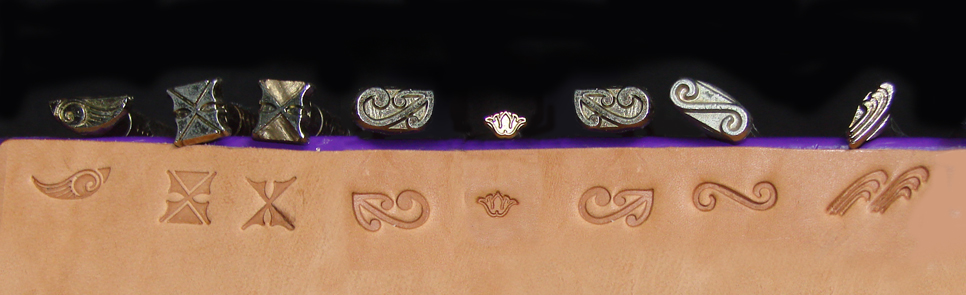

Stamps can be made from anything that you can fit under an Arbor press or workshop press. I found some interesting shapes at a general craft shop. They are called jewelry "findings" and made from brass. As per pic, they come in packs of 3 for around $2.75. I simply filed off the attachment loops and super-glued them to some scrap aluminum to make sure they didn't bend in the press. I have also made stamps from metal buttons glued to wood.

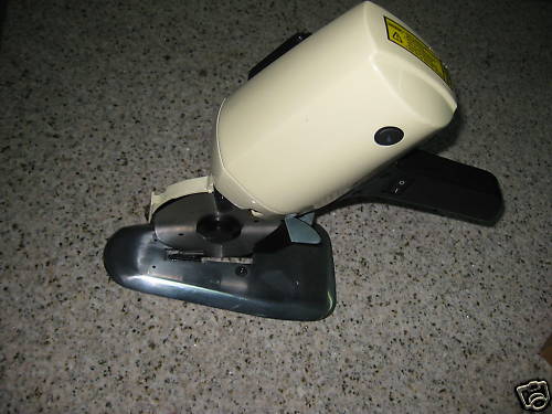

I have an opportunity to buy an Industrial fabric cutting machine, but I don't have the option of trying it out. Has anyone here used similar to cut leather? If so what weight leather do you think it will handle? Any imput is appreciated.
