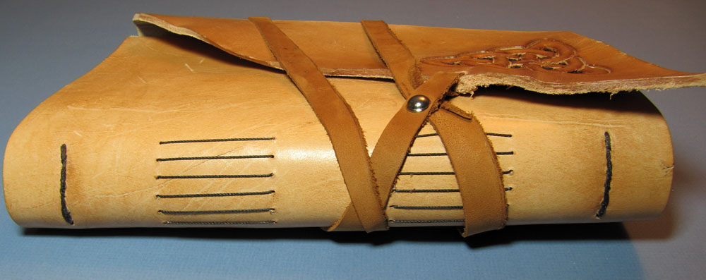

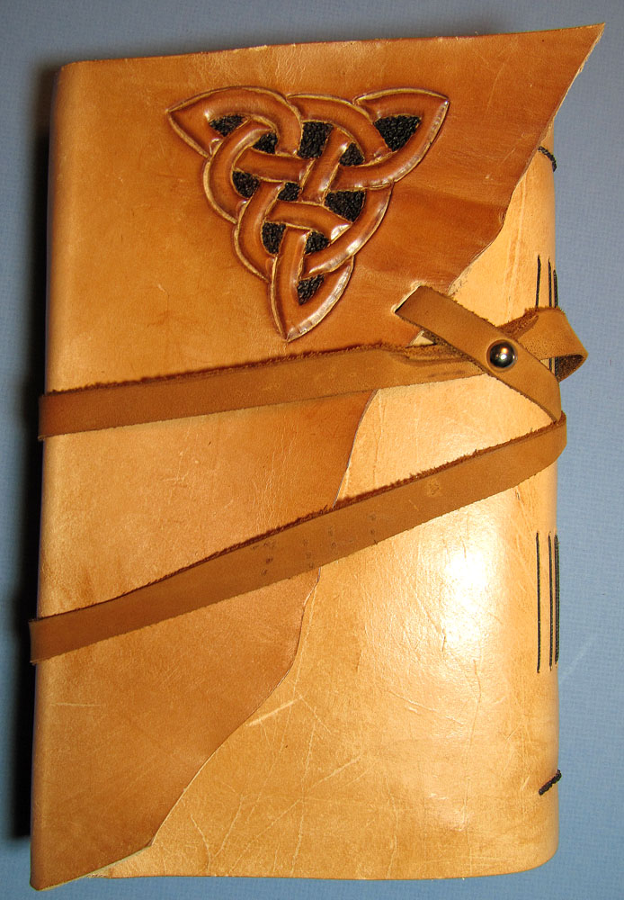

I just finished these two. The first is a small executive portfolio, designed to hold s 5x7 notebook. I used the European tanned leather from Tandy for it. It tools very nicely! After oiling, I applied several thin coats of Acrylic Resolene as resist, then antiqued it with Feibings mahogany antique paste. Finished with two more coats of A-R, then two coats of Tan-Kote. It's sewn with natural colored thread. The second is a sketchbook/journal, made with that really torn up leather I got on sale from Tandy. I tooled in a Celtic knot and then dyed the background. Finished with four coats of Tan-Kote. Hand sewed the paper, Canson 80 pound art paper using a long stitch. It measures 7.5x10 and holds 240 sheets of 6x9 paper. Any critiques are welcome. Dave
