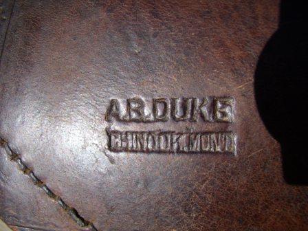

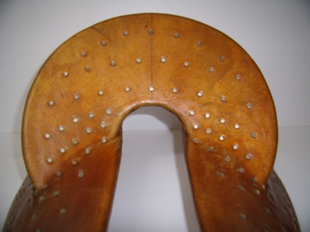

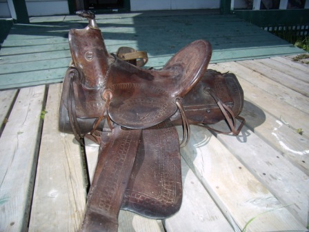

We stopped into a small, rural museum close to Grande Prairie, Alberta during our couple of days away. Our very spry 84 year old tour guide happily showed us around. He also showed us a saddle that had been donated only the day before, with the history that it was probably built in the 1890's. It has had some hard wear over the years and is now a victim of severe neglect, not to mention a very crude modification as what where probably square skirts were cut off to make rounded skirts. However, the maker's mark, which appeared on the seat and the back corner of both skirts was quite clear: A.B. Duke, Chinook Mont. In my extremely limited internet search ability, I was unable to come up with any information on this saddle maker. Any one out there know anything about him? The museum would be interested. Thanks.

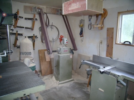

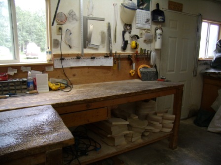

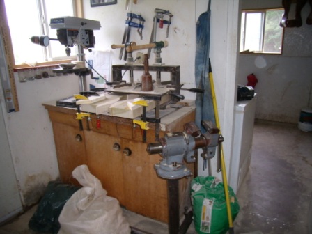

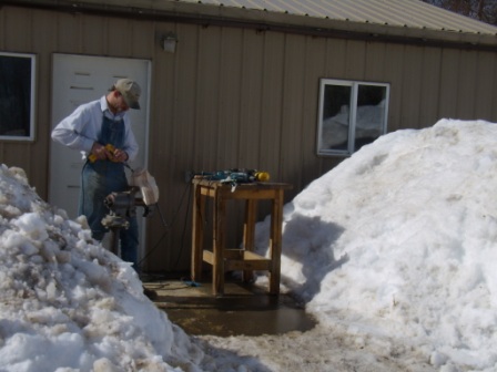

And now, for something completely different: Here are some pictures of our tree making shop, for interest's sake if nothing else. The wood working part is 20 x 16. It is dominated by the 32" bandsaw in the center of the floor. This saw is designed to saw logs into lumber. We need height for the jigs used to make the cuts on the bars for the fork and cantle to fit into. We use a 1/4" furniture blade on it so we can make the tight turns we need inside the gullets especially. The table tilts so we can cut at different angles, and the blocks in front of the bottom door are used to keep all those angles consistent. Behind the bandsaw is the modified belt sander. Rod uses the wheels at the bottom of the belts to shape the wood - the small one on the right for gullets and the larger one for everything else he does. It is amazing how much wood this thing will eat very quickly. Hanging on the wall to the left of the sander are the jigs used to make those all important cuts in the bars. And to the right is the 12" jointer/planer combination machine. You "joint" on the top, then the tables flip out so you use the underside of the same blades to "plane" or thickness the wood. Moving around the room, you come to the glue corner. There is a Wade fork in the glue press, with the layers for another Wade being laminated side to side in the clamps sitting on the bench to the right of it. On the wall to the left are jigs used to cut the cantles at different angles. Behind the glue press are patterns and other marking out tools, (plus the stack of orders waiting for us to get to them) while under the bench are specific sizes of laminated forks ready to mark out sitting behind stacks of wood pieces that have been cut, planed, thicknessed and edged and are awaiting their turn at the glue press. Moving along the wall is the large workbench. The next orders Rod is working on are on the cards hanging at the back of the bench, while the parts for those orders that have been marked out or already cut out ready for shaping sit underneath. This bottom shelf is also where Rod also stores his side grinders. There are more patterns and more marking out tools on the wall here as well. Behind the door is the drill press Rod uses for metal horns, and a second glue press with a set of bars in it. The drawers and cupboards contain other hand tools, small pieces of wood for horn caps, and other odds and ends. The vise on the stand gets dragged all over the shop and to the cement pad outside when the weather is nice. Rod clamps the wood in the vice, which can twist and turn all directions, and goes at it with a carbide wood carving disc on a side grinder, sending dust everywhere. Summer, when he can work outside, is much nicer in the shop. Through the door way is the 10 x 16 "rawhide room", which right now only contains the Great White Shelf (aka the freezer where the hide is kept until needed) and the small room with the furnace and hot water heater, etc. In the summer, making rawhide is an outside job. Below freezing (November to April here) Rod uses the rawhide room. It's walls are plastic sheeted to keep them dry. We try to fill the freezer in the fall before it gets too cold so that it is at least late January before he has to make rawhide inside. Past the doorway is the wood stove in front of storage shelves for horns (getting low at the moment) glue, varnish, etc. On the back wall is the starting point for all the trees - lumber. Different woods are on the different racks. Below the wood are trees in varying stages of drying sitting on 1" thick, totally flat pieces of marble, weighted, wrapped and "pounded" as needed. Summer plans for this year include adding an extra 12 feet out the north end of the shop to make room for a much better dust collection system. It will have a separate small room for the cyclone, and a "dirty room" for Rod to do his grinding in. It will also give us room for more bench space so Rod doesn't get in my way quite so much. Dust is what kills or stops the careers of a lot of tree makers, so we are looking forward to drastically decreasing the amount of it that we breathe. The last picture is just to prove that, in order to cut down on the dust, Rod works outside as often as he can. It was taken on March 24th of this year. PS. As for what we do with our scrap - we use it to lower next winter's heating bills!
