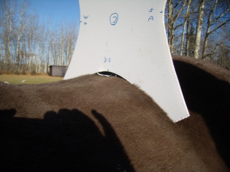

Romey, it IS very straight forward. Dennis has worked with this to make it as easy as possible to use, even by horse owners who know nothing about fitting saddles. They can fit the cards to their horses and give the results to their saddle maker. Once we check out a bunch more horses ourselves, we will know what is more "normal" in North America, so if we get some "odd" numbers given to us, we can recheck them to make sure it was done right. If the owner has a number of similar horses, we can make a tree to fit that average shape or "style" of horse. If they have horses that really vary in size and shape, at least we know that and can tell them that one saddle will not fit all their horses well, and it will be easier for the owner to see why. The neat thing about this system is that it lets every tree maker decide how make his trees fit the different shapes. The saddle maker would no longer have to worry about whether he ordered the right size for that customer's horses. It is difficult to know how one maker's trees fit compared to another's unless you have a few trees and a bunch of different horses all at the same time. Now, they would just give the information from the cards to the tree maker, who would then know what the shapes of the horses this tree is being made for. The tree maker, on the other hand, can work to fit a quantified shape, and not base their fit on a description like "big, wide Quarter Horses but with good withers", which is often the best we can get now. Even people who ride many different horses often ride a general "type", and that style can be quantified with this system. If they ride many different types of horses, they will know what shape this saddle will fit best and can decide what to do padding wise for ones that are close to that shape, or know that they need to change saddles for some horses. Being able to quantify a shape in some way has so many uses. We are currently experimenting with how these cards work and how we can use the information from them in building our trees. Some saddle makers are also trying them out so see if the system is useful for them. Dennis is very open to questions, comments, suggestions for improvements, etc. This is something that could be a very useful tool to help the industry and, ultimately, the horses.
Here is a pictorial tutorial of how Dennis Lane's Equine Profiling Cards work. This system is designed to enable anyone to easily determine the shape of the card that fits correctly at four different places on a horse's back. The numbers can then be communicated to anyone else who has the card system - saddle makers, tree makers, etc. Dennis has used the system well in Australia with his trees, and has now made it available to us in North America. A number of people are trying it out. Dennis doesn't do a lot of on a computer, but has worked with us on this post. He is looking for more saddle makers to test out his system and communicate back how it works for them. He appreciates any comments about the system as he is trying to make it as user friendly and globally accurate as possible. 1.) Become familiar with the cards. There are four different shapes (S4, S5, S6, S7) on the S cards and four (D4, D5, D6, D7) on the D cards for each of the A, B and C positions. There is one extra card that has the A, B, and C position for shape D8, and a D9 shape for the C position. There are three shapes to determine rock - R9 is the middle, R6 is flatter and R12 has the most curve. There is a "ruler" on a rock card to help you measure more conveniently. 2.) Stand your horse as squarely as possible on flat ground. Find the lowest spot on your horse's back. This is the B position. 3.) Using a ruler, mark a spot 8" behind this spot. This is the C position. 4.) Feel for the back of the horse's shoulder blade. Mark this spot. This is the A position. 5.) Measure and record how far forward this spot is compared to the low point of the horse's back. (This horse measures 8".) 6.) Take one of the cards for the B position and place it on the horse's back at the B position you have marked. You are trying to find the shape that most closely matches the shape of your horse. Record this. This one obviously doesn't fit. But this one does. 7.) Do the same for the C position. In all cases you are looking for fit all along the card, but especially where the bars fit on the horse's back. This one still has some clearance in the center, and the ends stick in a bit. This one fits. 8.) And the A position. This one seems to fit well down below, but the shape is wrong up top. This one fits. 9.) Next, measure 3" down from the centerline of the horse at position B. 10.) And C. 11.) Place the rock patterns perpendicular to the horse (not vertical compared to the ground) along this line 3" off the centerline. Make sure the center mark on the pattern (marked 14 V) is at the B position. Keep the horse as square as possible with his head in its normal working position. You are trying to find the card that most closely matches the shape of your horse. Record this. If the card has too much rock compared to the horse, it lifts off the back. Too little and the center doesn't meet, as in this case. This one fits all along. 12.) Fill out the form sent to you, including the horse's name, age, sex (and number of foals if a mare), breed, what they are used for and any other comments about the horse, along with your results. Send it your tree maker. Dennis also asks that you send him a copy, via e-mail or snail mail, so that he can continue to build his data base and improve his system to fit the North American horses as well. Dennis is now a member of this board. If anyone is interested in getting a copy of Dennis's system, please PM him. If you have questions about the system, or comments on what you have found in using it, please post them. The more discussion, the more we learn!

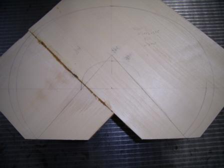

Answer - it might, but it doesn't have to. Depends how you make them. In this picture, I have drawn a wider cantle as the starting point. Then I have drawn a narrower one as well. On the right hand side (looking at the picture) I drew the cantle so the point is a bit up the line which would move the points back and up on the bar. On the left hand side I drew it so they both came to the same point. Either one would make an acceptable cantle. We decided a number of years ago that in order to be as consistent as possible with thigh length, we would keep that point the same on all cantles (with very rare exceptions). So on our trees, no, the shape and width of the cantle doesn't affect how far down and forward the points go on the bar. But on other maker's trees, it might. And in comparing between makers, your guess is as good as mine. Another factor that David didn't mention but that also makes a difference in where those cantle points end up is the angle of the cut on the bar (or, for those makers who don't have a cantle cut, the angle on the bottom of their cantle). Here are two pictures of cantles with two different angles to that cut on the bar. (Please ignore the writing on the pictures, but these are the clearest ones I have at the moment.) I assume every tree maker has slightly different angles here, which is just one more reason why you can't compare between makers without actually looking at the two trees side by side. Just a quick note on the two trees you have listed that we built. The High Country has a stood up fork, which makes the thigh length longer. But it also happens to have the cantle at the most laid back angle we make, which makes it shorter. The cantle could easily be stood up another notch, but the thigh length on this tree as is will be large enough to fit all but the very largest riders out there, so it is unlikely that you would want to do that with this tree. That Wade has the cantle at the middle angle, and it also could be stood up a notch or even two to increase the thigh room if you wanted. (If you keep the seat length the same and stand the cantle up more, the effect is to hold the middle of the top of the cantle in place, and move the bottom back, which increases the thigh length.) These are the types of things that can be maneuvered to get the thigh length the rider needs, even if they are set on a specific number for seat length and won't listen as you tell them that it really doesn't matter that much anyway.
