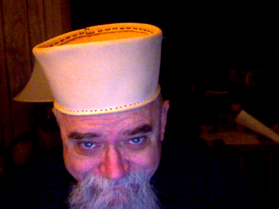

One more note on this. The top of my head is a mere fraction of an inch from the top when it set properly on my head. This is a factor when you decide how short to make it, you don't want somebody's hat looking like a dixie cup on an beer bottle. -

That's 3-4 oz. throughout. I've used a mix, 2-3 for the top and both brims and 3-4 for the crown. I did one that was camo'd and I used camo cloth for the top. A nice way to ventilate and save weight at the same time. The next one will have horns. -

I'm going to Michael's and see what they have for that hat. Those are from the necklace section, you can get whole strings of tiger's eye and such for a reasonable price there. That band in the picture is a swap out band I wear when the cobra skin band isn't appropriate. I'll get a picture of it with the original crown pattern in the same picture for comparison. Give me a couple of hours. The brim is really firm. You have to follow the pattern and use two layers of leather. I think from now on I won't glue them together until I have the brim attached to the crown, it's a lot easier to lace up that way. -

Problem with that is there's a dog-leg in the sides when you do it that way. I fought it out this afternoon and got it to work. I made a copy of the crown pattern and counted down 7 holes (out of 20). I put the old pattern on the new one at that point, making sure the overlap on each side was equal (1/2 inch in this case on each side.) Then I marked the new top of the pattern. All I had to do then was link the top line with the bottom one and transfer the holes from the old pattern. Fits just fine. Caveat: Those measurements are for the large Aristocrat, medium and small will have less overlap, I think. If I do it again I'll go with 10 holes rather than 12. There's not enough difference between a full-scale crown and this shorter one for me. Again, your mileage may vary. -
I have a request to make a Tandy Top Hat from the 2062 pack that has a crown 3/4-2/3 as tall. I know that just dropping the edge down and tracing a new line will not properly transfer the holes. My only thought at this time is to draw many radius lines and disperse the holes proportionally. Anybody got a better idea on how to do that? Photo of the pattern can be uploaded if you want to see the crown, btw.
