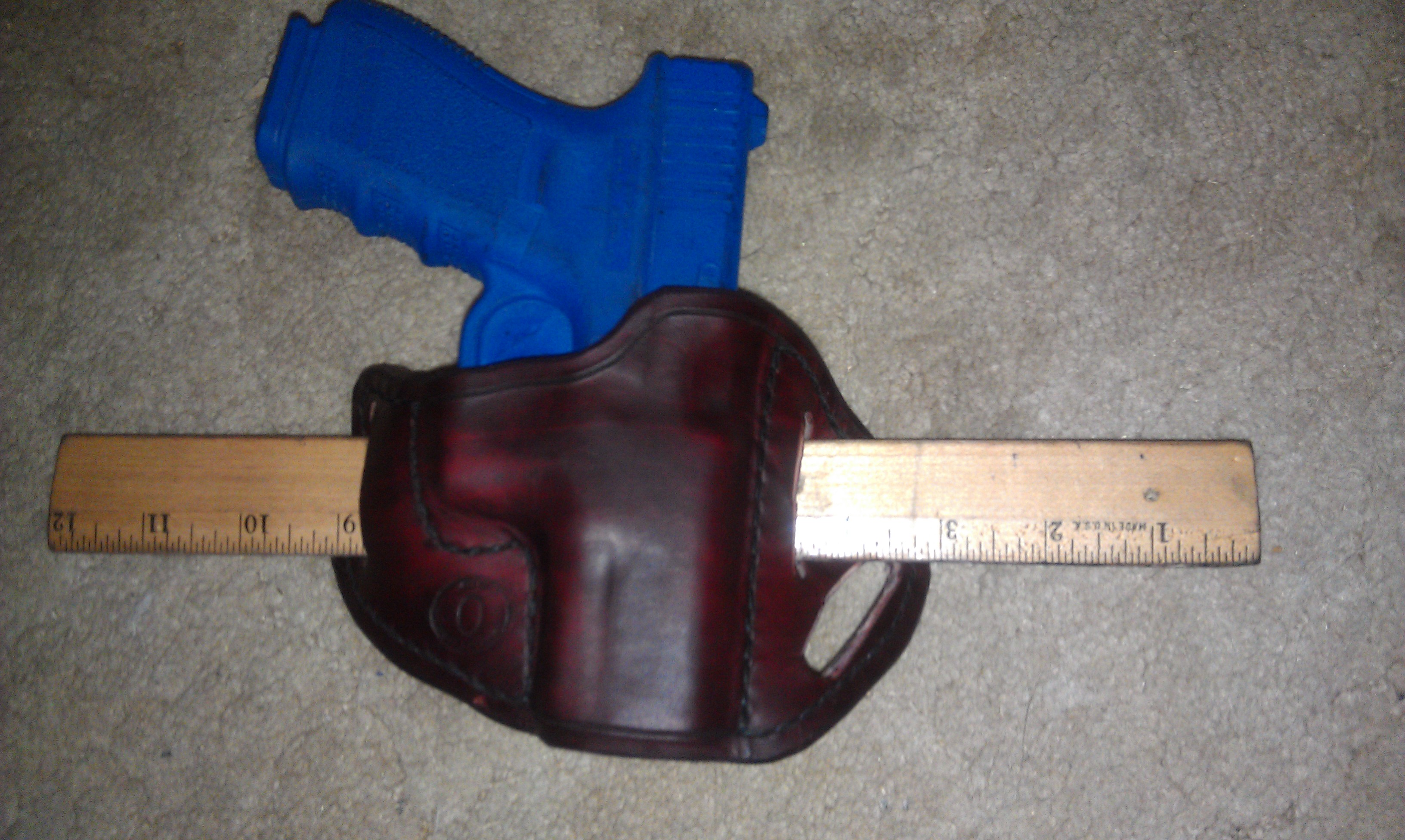

I've got to weigh in on this one. It looks like there's MAYBE a half inch of clearance between the point where the trigger guard meets the frontstrap and the top edge of the holster. Yes, the grip angles up and away, and there's room to wedge your hand partway up there. But that's not ideal. What IS ideal is the ability to get a FULL FIRING GRIP (minus the finger on the trigger) while the pistol is still fully in the holster. With the exception of hunting handguns, folks carry handguns in holsters because they anticipate the possibility of needing the handgun on very short notice to defend their lives. Under those circumstances, the draw is going to be as fast as they can manage it, probably faster than they've ever done it before, and a whole lot sloppier. The more advantages we can give them, the better. One such advantage is lessening the possibility of fumbling the pistol due to a haphazard, partial grip. Yes, on a casual day at the range, it's no problem to wiggle the gun into a proper firing grip after you pull it leisurely from the holster. In extremis, though, it's a big problem. -
