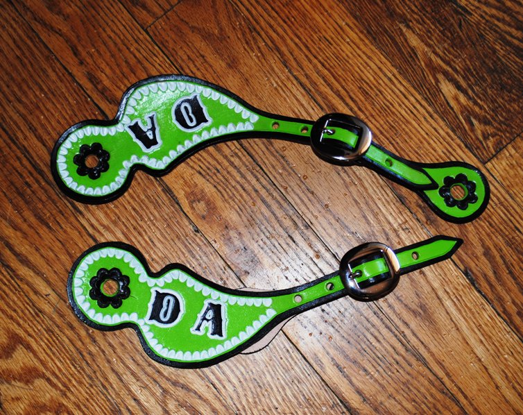

  1. I use markers all the time on my painted belts and spur straps for the lettering and have no problem the markers I use are acrylic based. Then I coat them with acrylic resolene.

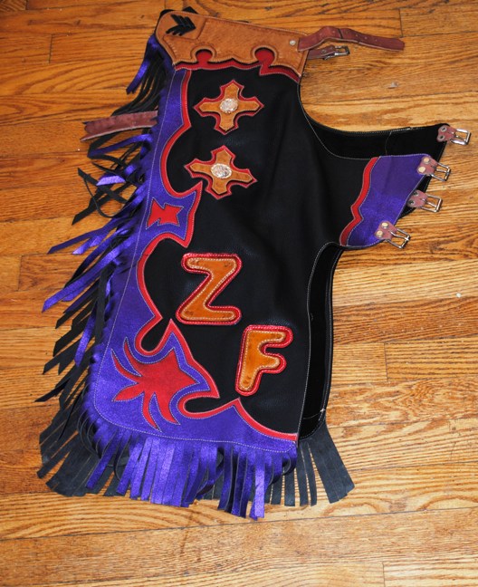

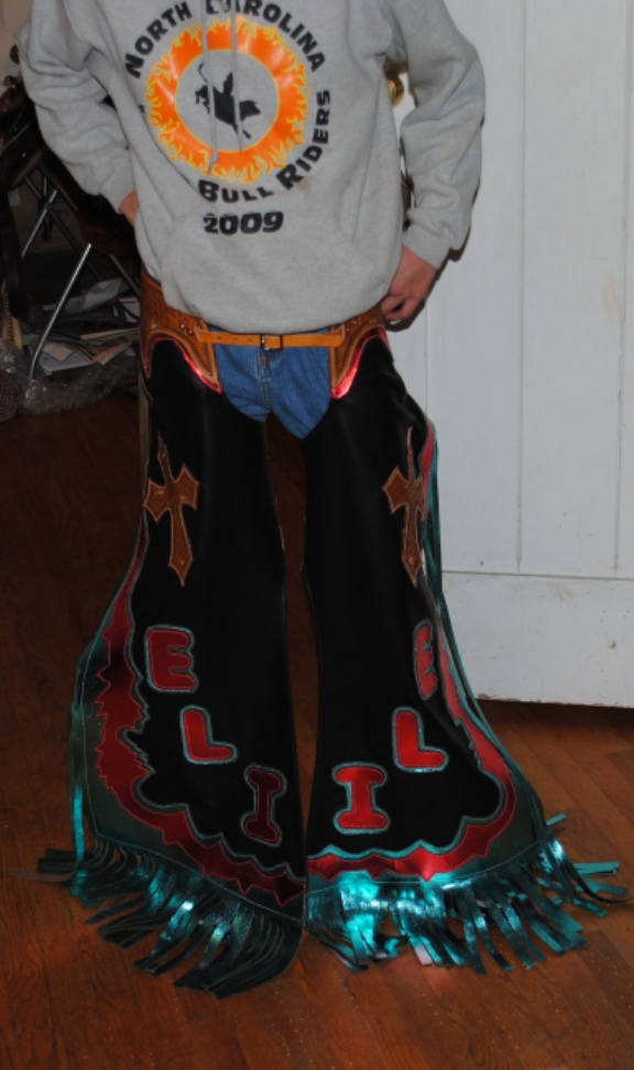

  11. Here's a pair of chaps I'm working on. to go with those yoke I post a while back. See what you think so far.

  16. The blue is turquoise. Apple barrel brand 2614. I mix it with water till it really diluted I apply it with a sponge brush lightly applying really thin coats drying between coats. I put as ever how many coats it takes not to see in more natural color. The I seal it with acrylic resolene. I lightly coat it until I reach the amount of shine i want. Be sure with the paint to apply thin coats at a time if you you don't you will get cracking when the belt is flexed a lot. hope this helps.

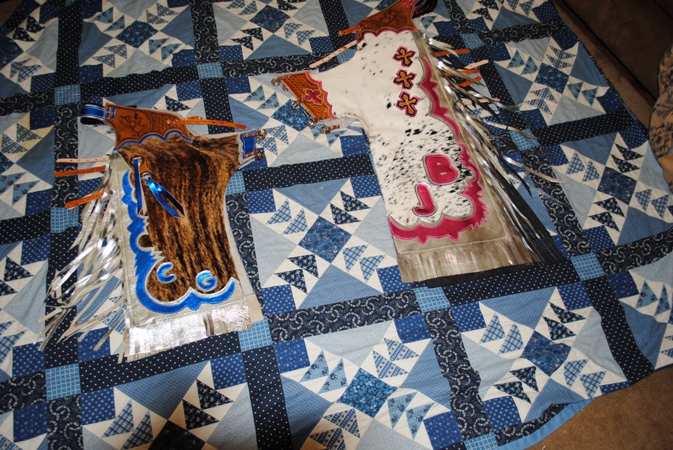

  21. It is a 6200g double needle machine.here is a website with the manual www.universalsewing.com/images/parts_lists/all/4j0mk4p7.pdf It sewed with the 138 nylon but skips some stitches and doesn't tighten up the thread well on the back I tried tightening the tension but it didn't help. I think maybe the needle was to small for the thread it had a 125/20 needle in it. It stitched great with the 69 nylon.
  22. I'm looking at a union special sewing machine and in the book it says 24-3 max cord. max usable thread.So what is the largest nylon thread it will sew with. Does anyone know?

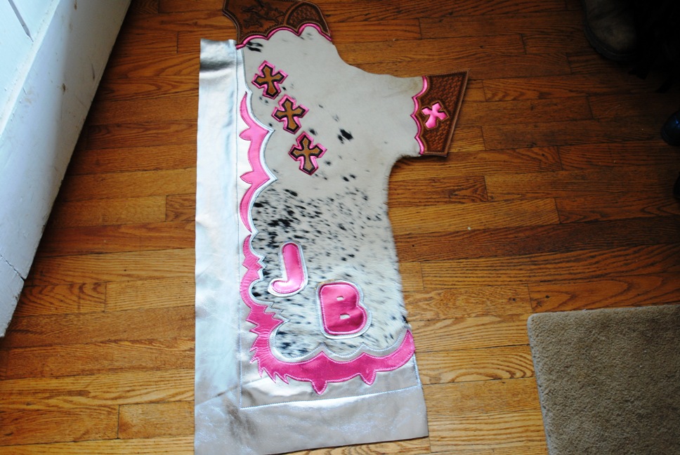

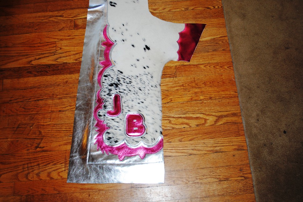

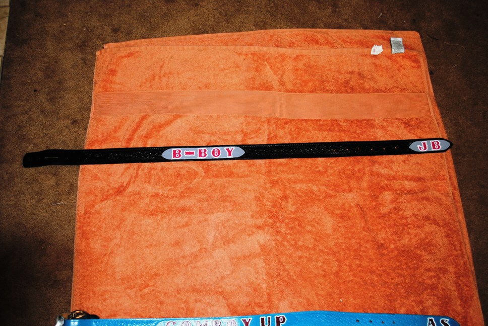

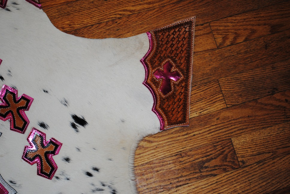

  23. This is the yoke use on most of my junior chaps.This set of chaps are going to be black and white cowhide. Hot pink and silver and metallic design like my son's calf riding chaps if you looked at those. The legs will have 3 crosses or one single large cross (waiting on the customer for that that) and the leg flap will have a basket weave piece with a cross inlay with the hot pink. The belt will have the boy's nick name B-boy on it like his belt I made him trimmed in pink. I just waiting on the leather. Here's his belt.
  24. This is my design. I waiting on leather to finish so when i get done I'll post them
