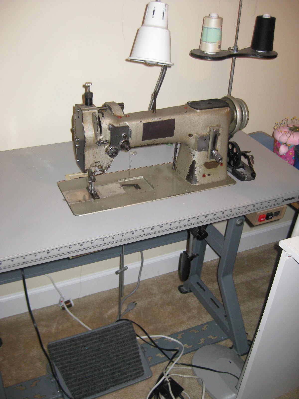

  2. I just picked one up for a pretty good price as well , it looks rough but seems ok mechanically , its on an old USM table . This link might help http://parts.singerco.com/IPinstManuals/111W152_W153_W154_W155.pdf
