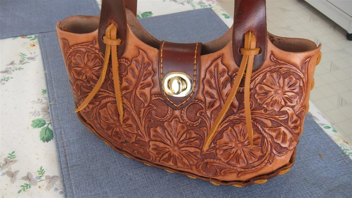

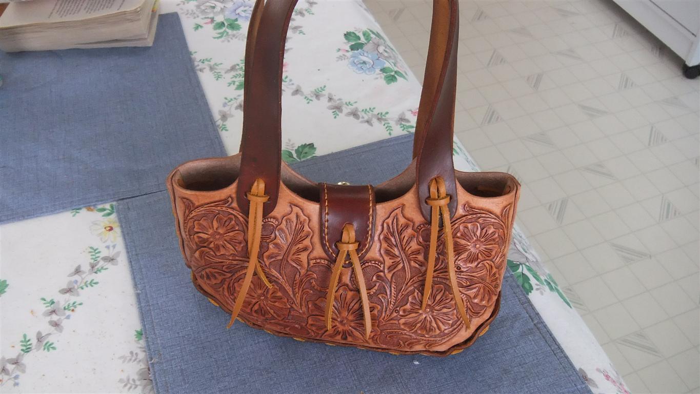

Hey. I've been away from leatherworking/tooling for a while (and I don't really know why) but have decided to work my way back in, gradually building my skillset. Attached is the first practice piece in maybe 3-4 years. Feel free to critique, as I can use some feedback. The pictures don't seem to do it justice to be honest, but I guess they rarely do, like a photo of a mountain and actually viewing the mountain for real are two totally different things...not that this simple piece is all that majestic. :-) Actually I am sorta happy with it, being the first attempt in a long while. Thanks!

Agreed. Very nice, and lots of intricate tooling there, without being too much. Keep it up! -

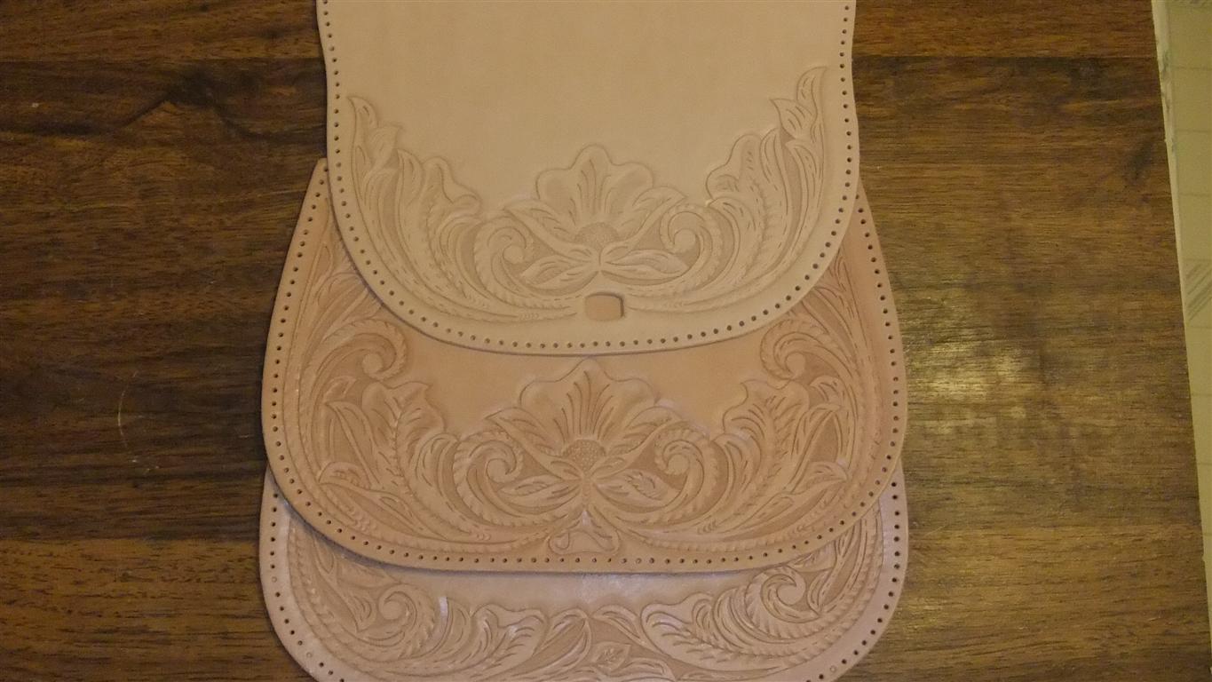

Thanks Aaron What do I do with the large non-tooled area...just resist it too, and antique that area as well although most of it will be wiped up, and hopefully all of it? I did a smaller project this way and the antique paste affected the untooled area, even after two thin coats of neat-lac, which is why I am concerned. If I only put the paste on the tooled area some of the paste can make it's way to the untooled area. Perhaps I need to clean up the paste better somehow. Attached is the picture project pieces, to give an idea of of what I am struggling with. Thanks, Clark
My project has some tooling at the bottom 1/3 of the pieces and the rest is non-tooled leather. I am trying for a natural, slightly brown finish by perhaps using saddle tan or light brown dye on the untouched 2/3 and to antique the tooling area. What I am having a hard time wrapping my head around is how to separate the two...I am afraid that the antique paste color will move onto some of the natural 2/3 unless I am super careful with the paste (and what are the chances of that happening, knowing how it gets everywhere)? Maybe I need to resist the entire piece (3 pieces actually so there is a lot at stake here, in my small leather-working hobby world) and apply the antique paste to the entire piece so that the coloring is uniform? I don't really want to do this as the paste will probably give the untooled part a look that I wasn't going for. I was also thinking of was just treating the entire pieces with Neatsfoot oil or EVOO and letting them darken in the sun...but by trying to highlight or antique the tooling areas is complicating this. Maybe I need to brush on the antique paste with a small brush and carefully wipe up the excess, antiquing a leaf/petal at a time? Here is an example of what I am trying for, only perhaps a bit darker: http://www.tandyleatherfactory.ca/en-cad/home/department/Kits/44373-00.aspx You can see that the petals and inner leaves are a darker brown, more that what I believe to the be simply tooling impression (I am not pointing at the black back-grounding) Anyways hopefully I have explained this clearly...for some reason I am at a loss on how to proceed, and very nervous about screwing it up after all the work that has gone into it (I am sure everyone has been there). Thanks, in advance Clark
