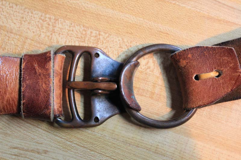

A friend has had this "belt" for over 30 years and it was old when she got it at a thrift store. I have looked everywhere I can think of to identify it, but have had no luck ,so I figured I would ask the experts. I am going to make her a new belt for it but I think it looks cool and would like to make some belts with buckles like it to sell. She said it was never brass in color, so I checked it with a magnet and it is magnetic. I also found what I think is an anchor on the back (see 3rd pic). I was thinking it was something to do with tack but now I'm wondering if it is military in origin. If anyone can identify it, has any ideas about its origin or where I might find more please let me know. Thank you for your help in advance. Ray
