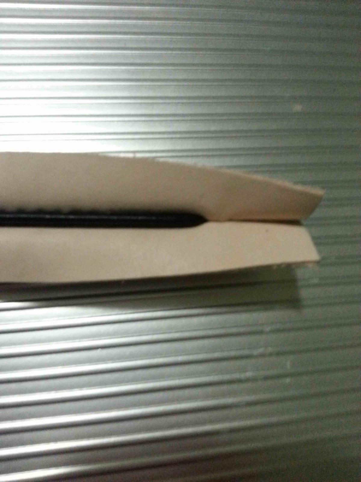

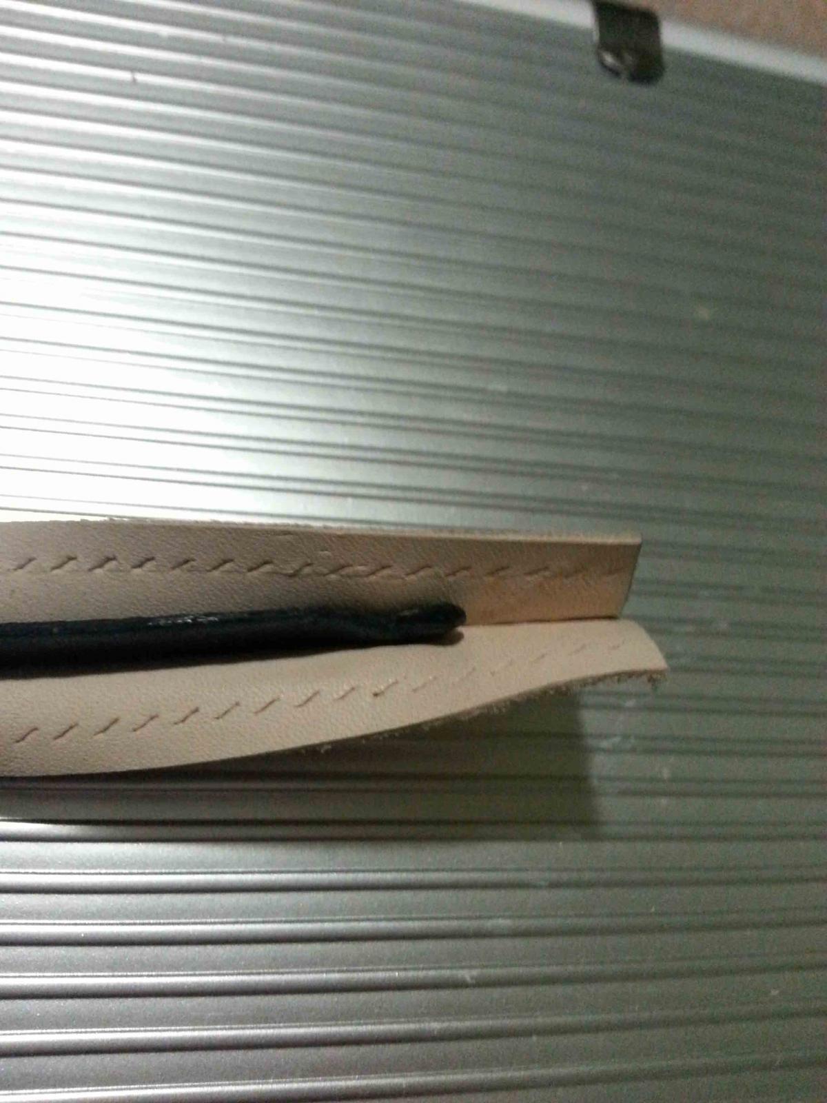

Practice piece Front side Back side before stitching close and before trimming the excess. There is no rubber core in the piping. My question to those that have done this with rubber piping would trimming it flush when its fed through to the backside be a problem in the future? Should it be a little longer or does it not even go into the backside?
The picture is saddle stitching, looks a LOT like machine stitching. I am more curious than anything. I don't think I had the threads both go in the same upward direction.
thanks kevin, the youtube page has a lot of new info. I think I figured out most of the ways you can cast the thread. One cast on one side iwraps the thread around each other once. Two cast (one on each side) creates a knot - doesnt work well on thin leathers. No cast at all the threads are separated the most, on a single cast it is compressed a bit and two casts the threads are compressed the most. When you cast the back thread forward the back stitch is angled up and the front stitch is angled down. Cast the thread towards you back stitch is down and front stitch is up. I still can't get the thread to go upwards on both backstitch and front stitch. Anyone has done this before?
