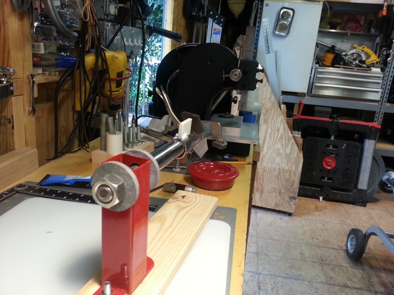

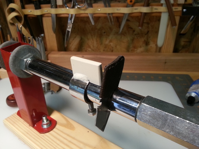

I put this string cutter together with some old chrome tubing and other scrap metal that was laying around the garage. I wanted to test it as is before bothering with the angle cut for the bevel cutter. It seems to be working well so I am looking forward to when I get a chance to make that addition. I have never actually seen a real string cutter so have nothing to compare this version to.

I made this silly little sheath to protect me from the blade on the string cutter that I recently built and have been experimenting with. It is actually hand stitched and has a welt.......LOL My fingers are too wide and my eyes are too old for me to mess around with anything this small but I thought I would share the funny little project....LOL But I have used the string cutter to convert a lot of tapered and hour glass shaped scraps into more useful leather string. .
