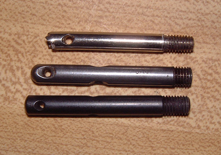

I bought my Chandsew 406RB with a broken spool pin. I ordered a new pin and received what must be a rather common size, as it's the same size spool pin as on my Singer 153. The original Chandsew spool pin is of a different diameter (smaller). Is this a common size? Easily found? Is there a size designation that I'd use for ordering? Needless to say, I can't use the new pin on the Chandsew. Photo shows: Original on top. Singer in the middle. New replacement on the bottom. Ian SF Bay Area http://imcinnis.blogspot.com/
