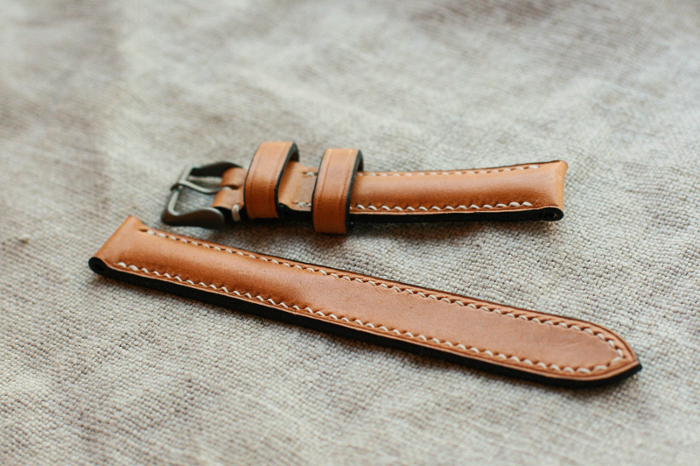

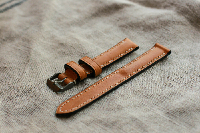

Thought I'd share a padded 18mm watch-strap I've been working on. Quite a lot of failures along the way but definitely helped to improve my attention to detail!
Watch Strap Prototype

Really nice work! The goatskin looks great. I've been working on a similar style of padded strap so I can concur, the level of concentration needed when working on something this delicate is really quite challenging as the smallest of imperfections end up looking really exaggerated. Looks like you're really perfecting your technique. I absolutely agree. Making an ordered list of each process is the only way I can stop myself from rushing ahead, then having to back-track and ultimately making a mess. Look forward to seeing more of your work -

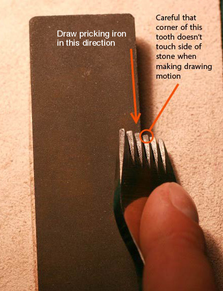

Thankyou fellas for all the suggestions! Sounds like I should give it a go then. I've sharpened plenty of chisels but this just seemed uncomfortably small to me. I have a little Fallkniven stone that would be good for this. I just noticed when laying the pricking iron with one tooth flat on the edge of the stone, that the tooth below rests very close to the side of the stone, so there's some danger of grinding the corner off of it if care isn't taken. Difficult to explain so I've attached a pic. Is this the correct way? Will give the wet&dry method a go too to see which feels more comfortable. Guess it's just a matter of personal preference. Nige - I'm sure another of your videos would be gratefully received by all the less experienced members of the forum. There's no substitute for seeing something done up close. Really appreciate all the time you've put into them! Ski - Cheers mate, I'm down south but kind of you to offer!
Thanks Nigel. Difficult to show it clearly but you can see the corners are slightly rounded off. It's probably fine really but it just annoys me thinking about it when I'm using it! Dixon tools have kindly said they would take a look at it so hopefully they can get it back to it's former glory.

No worries, I appreciate you chipping in. I've not used such a small stone before but it looks like it'd be perfect. I would just be a bit nervous about maintaining a consistent angle on every tooth while sharpening but I'm sure it could be done. I'll definitely keep it in mind if I can't find a company to do it. Looks like it'd be useful to have one regardless. Cheers
No, I just accidentally punched through on a very thin piece of leather and also went through the scrap that was underneath it. I usually just break the surface of the leather and finish the hole with an awl. The reason I want to sharpen up the teeth a bit is that I'm using some smooth chrome tanned leather and its quite easy for the pricking iron to wander off the line when marking stitches. If if was sharper I think It'd grip the surface better.
Does anyone know a good sharpening company in the UK who can sharpen pricking irons? I rather stupidly wacked one of mine several times into a piece of iroko wood; now the teeth feel a little dull. It's not a Dixon one so I don't think they'd deal with it. Cheers ! Edd
