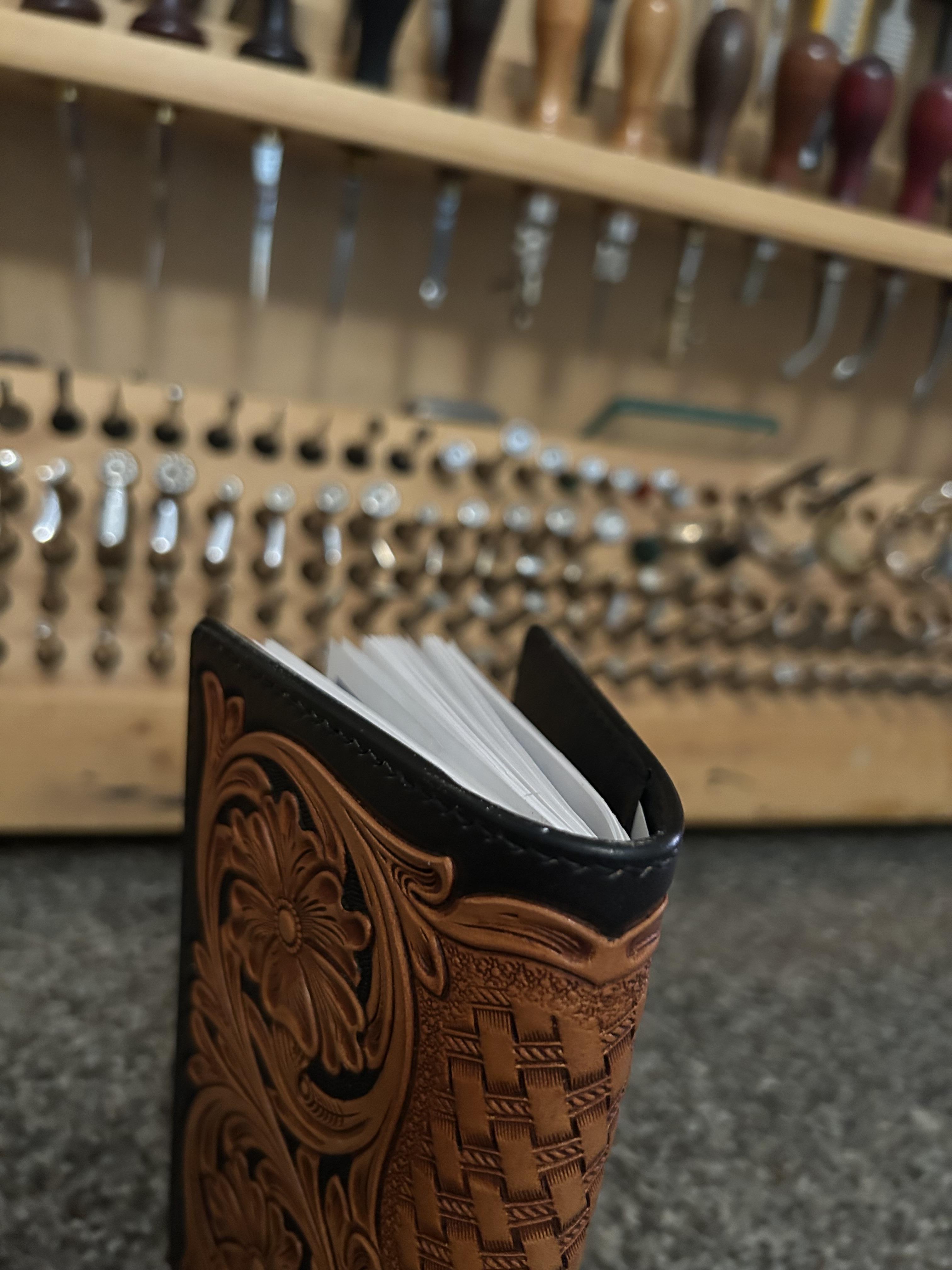

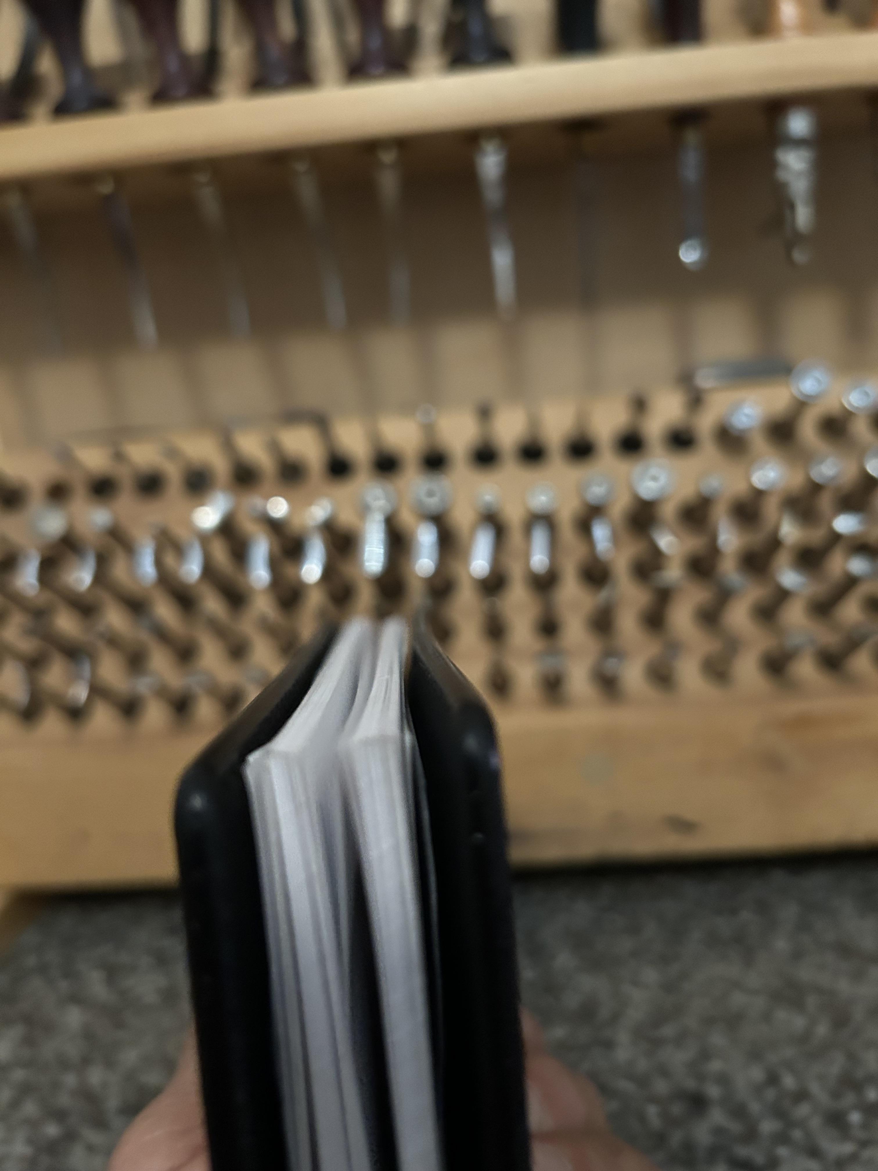

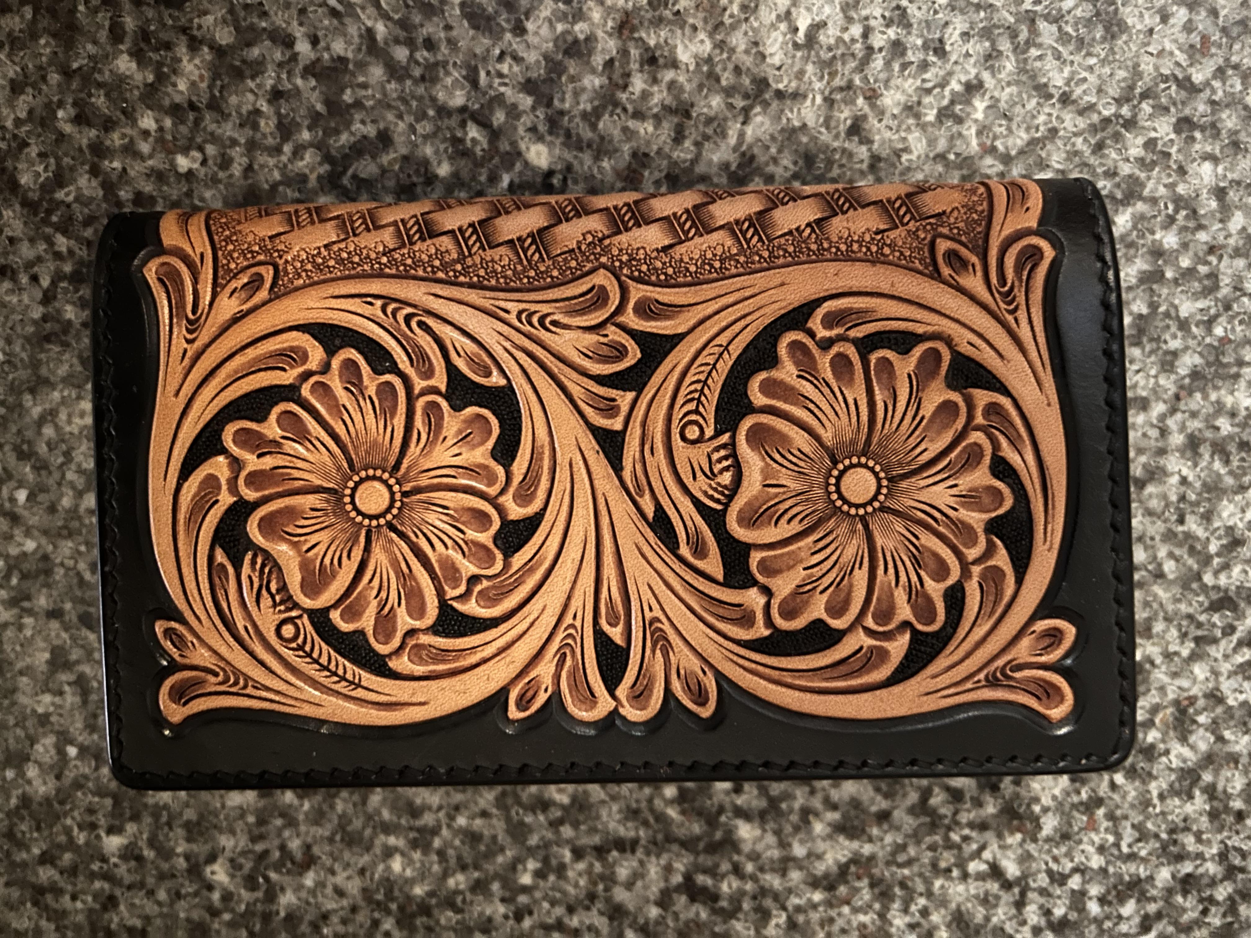

We’ve been iced in since Saturday so decided to practice a little. Made this cover for my daily planner. 3/4 oz Hermann Oak with a pig skin liner. It’s just dyed black and Sheridan Brown antique finish over natural leather, no resist. I haven’t put a topcoat yet. Want something I’ll be able to clean and oil later. I usually Wyosheen everything and I don’t like the way water base finishes look. Oil just seems to sit on top of the Wyosheen. Any recommendations.
