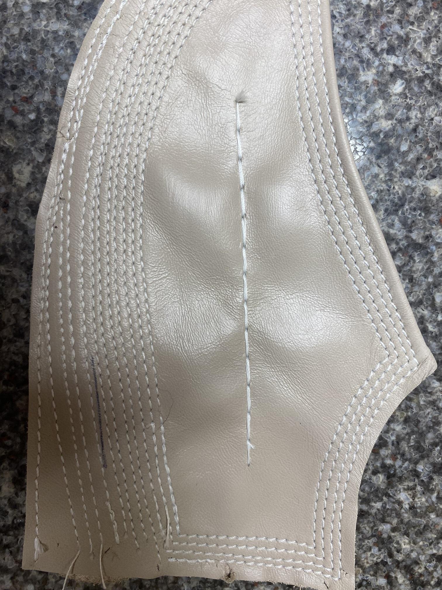

You can make these machines sew backwards in the same holes. Here's 13 stitches forwards at max stitch length then backwards then forwards again. This is 2 layers of 2/3 oz. chrome tan with #138 thread using HE&P #25 needle plate and feed dog. The back looks pretty much the same. This the only machine I have been able to make stitch backwards in the same holes and the back looks like the front. Not sure how the little slide plate that comes in the top of the stitch length adjuster works but I removed it and started shimming the bottom until I got it right. Just curious if you are going thru the eyelet then around the tension disc and then back thru the eyelet again like Cobra says to thread machine. That creates unwanted tension you can never get rid of. Try threading the machine without going back thru the eyelet on both the top and bottom tension disc. -

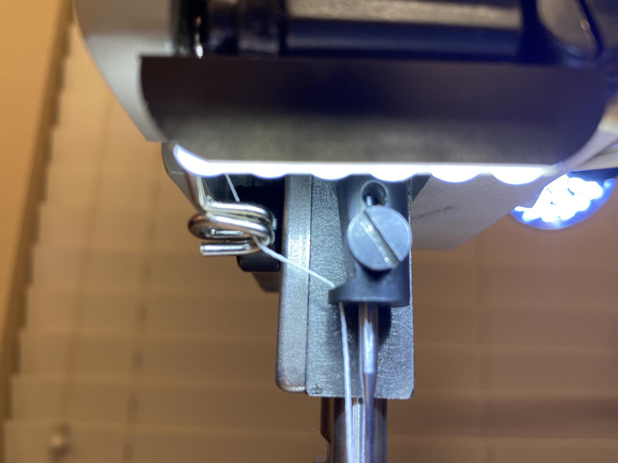

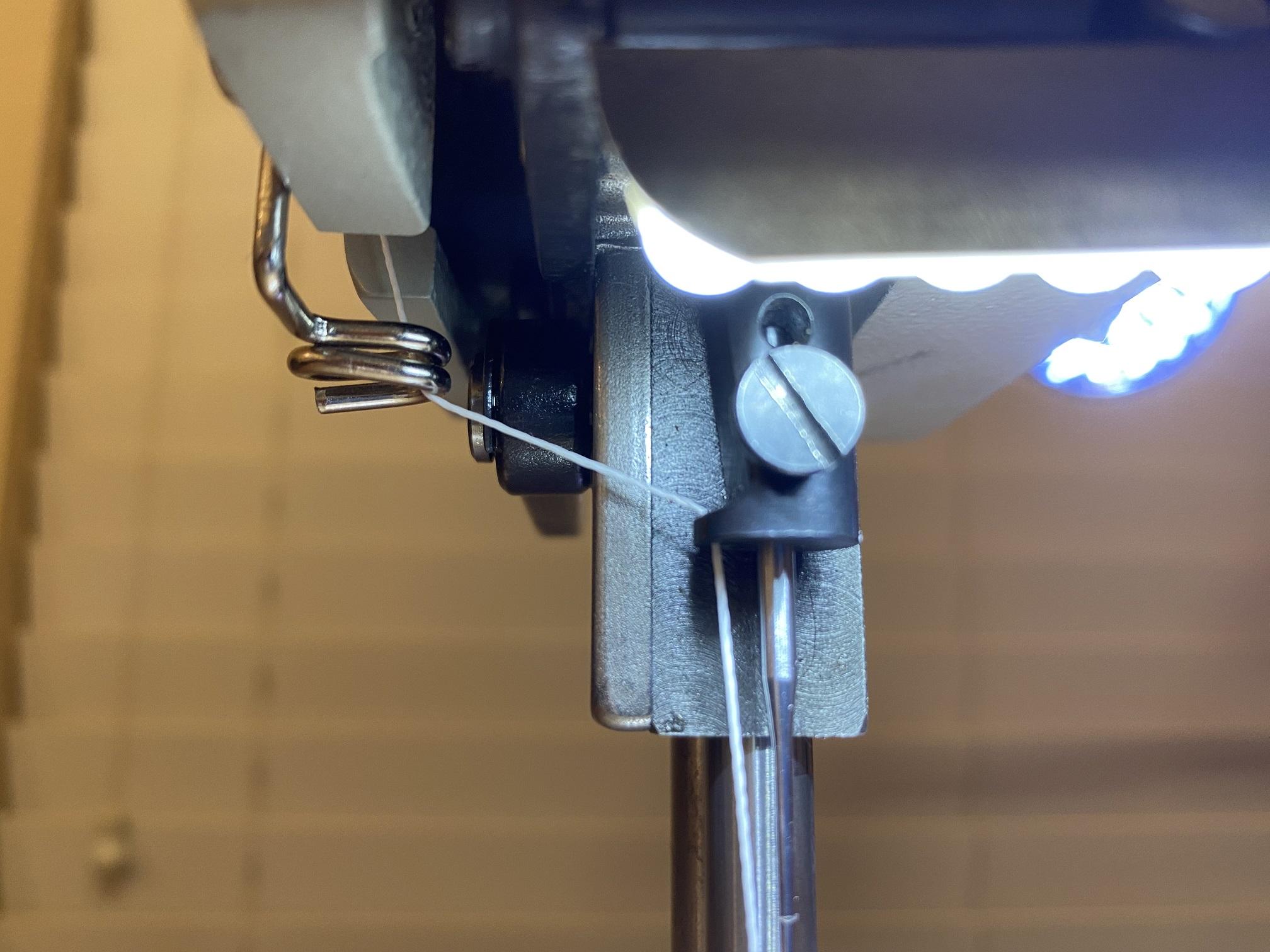

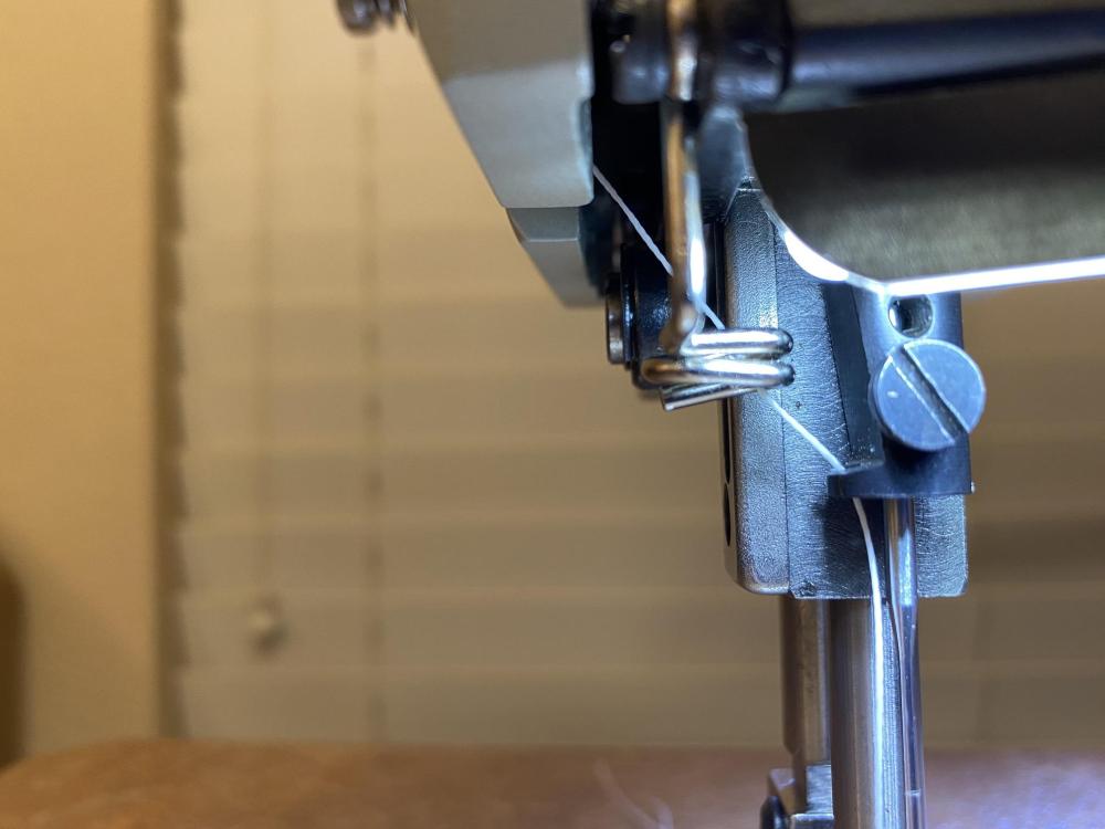

Here you can the path of the thread with last thread guide in the 3 different positions. I have found videos on YouTube where they would skip the last thread guide completely.
Going thru the bottom eyelet before wrapping around disc 1 1/2 times creates upper thread tension you can't get rid of. I looked up every manufacturer I could find, and Cobra is the only one who goes thru the eyelet before going around the disc. It is OK on bigger thread and needles but will never let you loosen the top tension enough to sew on the lighter end capabilities of this machine. You don't need another piece of leather. Don't go thru the bottom eyelet before going around the disc 1 1/2 times and tighten the bottom tension. I would still move the last thread guide to the inside of the faceplate.

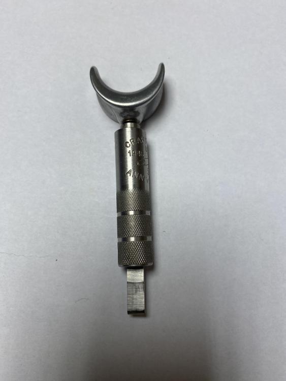

Try to feather everything. Shaders, bevelers and decorative cuts. Everything starts deep and feathers to nothing. When you cut the pattern try not to let any lines touch each other. I try to cut a little less than half way thru the leather and then bevel firm not hard and not soft. You can fine detail the inside corners with the background tool and modeling spoon. Point the shaders towards the middle of the flower and the center of the leaf or whatever they are. You can walk the shaders like the bevelers. A little tap tap tap as you are moving the beveler or shader. Bevel all the lines that run into another line first then bevel the ones they run into. Try to make the background area as small as possible. It's a lot easier to make a small area look good with bargrounders or a regular background tool. I trace outside my lines and then by the time you cut and bevel the background area will be the size it is in the picture. I do use some special swivel knife blades. The blade I cut the pattern with is a Leatherwrangler that has been ground down to .040 and decorative cuts with one ground down to .025. Standard is .0625 You can still make it look good with a standard blade. Depending on the leather you are using the tool imprints should be darker like burnishing. Especially the beveler and shaders. Usually if it's not leaving a burnishing color the leather is still to wet. -
