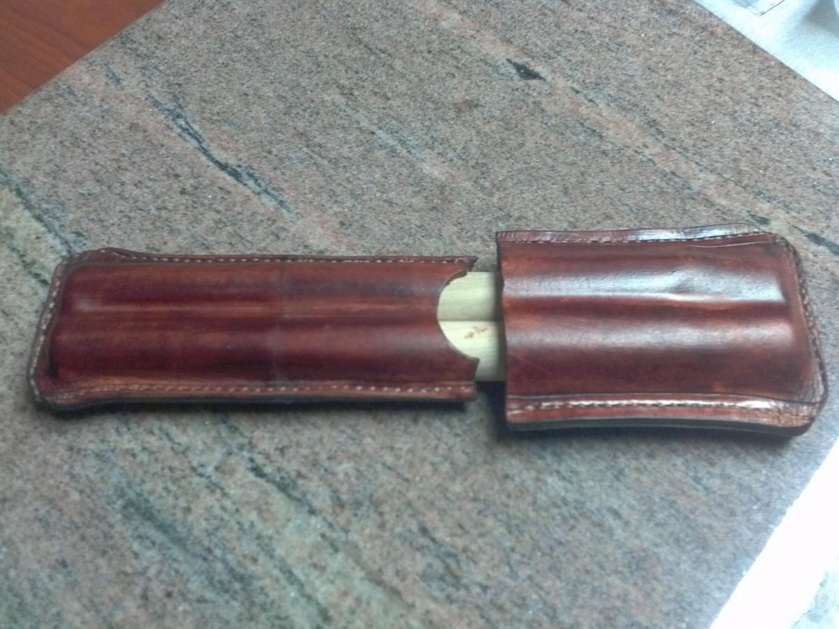

I used 19mm(3/4") wood dowel for mine,cut to 155mm(6") Once I determined the size and final shape the case needed to be. My assembly went this way; cut 4 pcs of 5oz veg to size and also cut out my recess for the bottom Run the stitch groove Run the lacing chisel for my holes Tool any designs into them (Ileft this one plain) Stitch away with my Awl Wet and insert the 2 dowels and form After drying, trim away the extra along the stitch line and shape edges Paint and burnish the edges Dye, dry and buff, I used a beeswax/oil mix for a sealer/polish on mine
