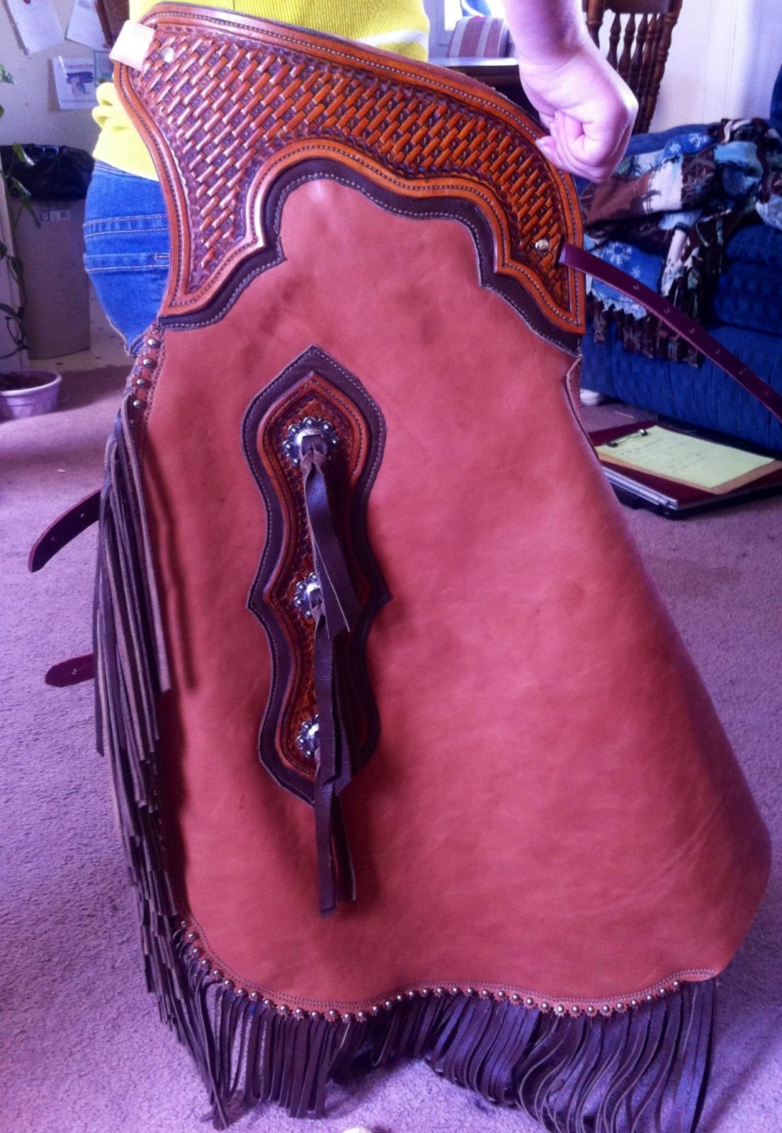

These have been a long time in the making. We interrupted leather working time for calving season, then AI'ing.. Haha. I made them out of a 3-4 oz chrome leather with 3-4oz fringe, accented with spots set into pinking borders (thanks Bruce for the pinking punch!) Yolks and side plates are 8oz veg tan with basketweave tooling. I need to help the water edges on the back belt but other than that I'm pretty happy with them

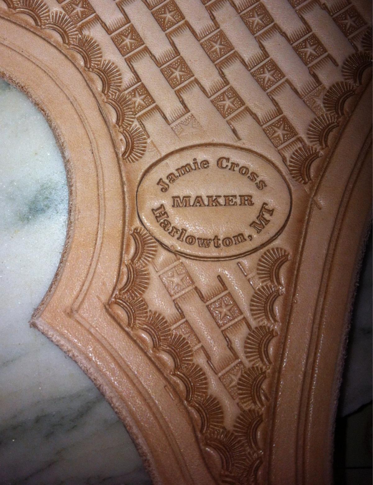

Hi everyone, I'm building a pair of chinks and am having trouble with stamping around my makers mark. I thought I should stamp the mark first since I want it to be very clean looking, but now I'm not sure how to go about getting the basketweave right up to the edges without overlapping. Attached is a pic of how far I've gotten Same thing with the border stamp. I probably should have stamped the mark up higher but it's too late now. How does one normally go about using a makers mark with a basket stamp? Thanks!
