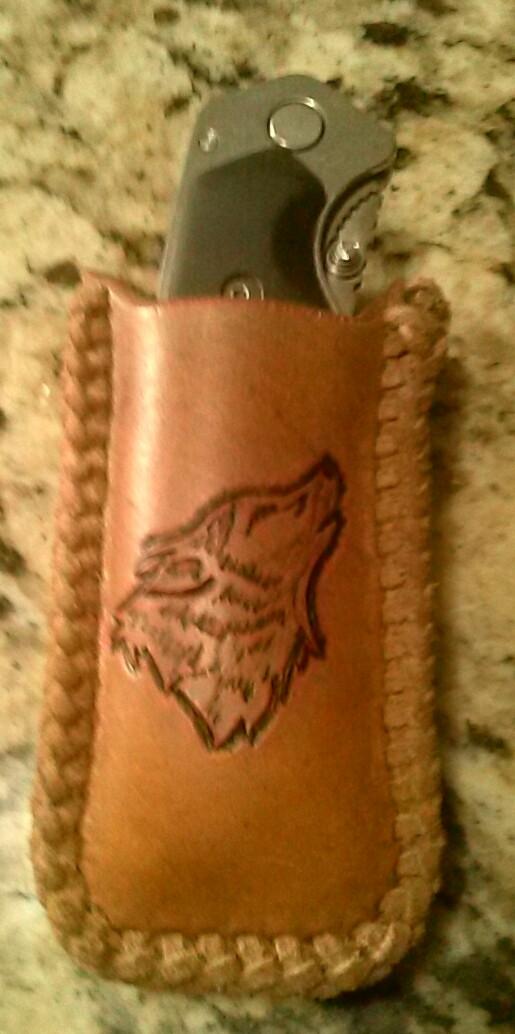

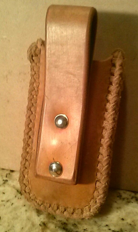

My father wanted me to make him a belt sheath for his folder. He wasnt too particular about details so I just ran with what came to me. I wanted to do some tooling, but the limited space meant it had to be small...small details have kicked my butt so far, but not being easily deterred, I figured I'd try a small wolf head. All in all I'd say im fairly happy with the end product. I still need to,figure out how to properly start and end this damn edge braid, though! Lol...opinions and critiques appreciated!

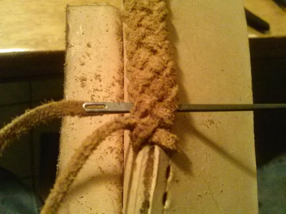

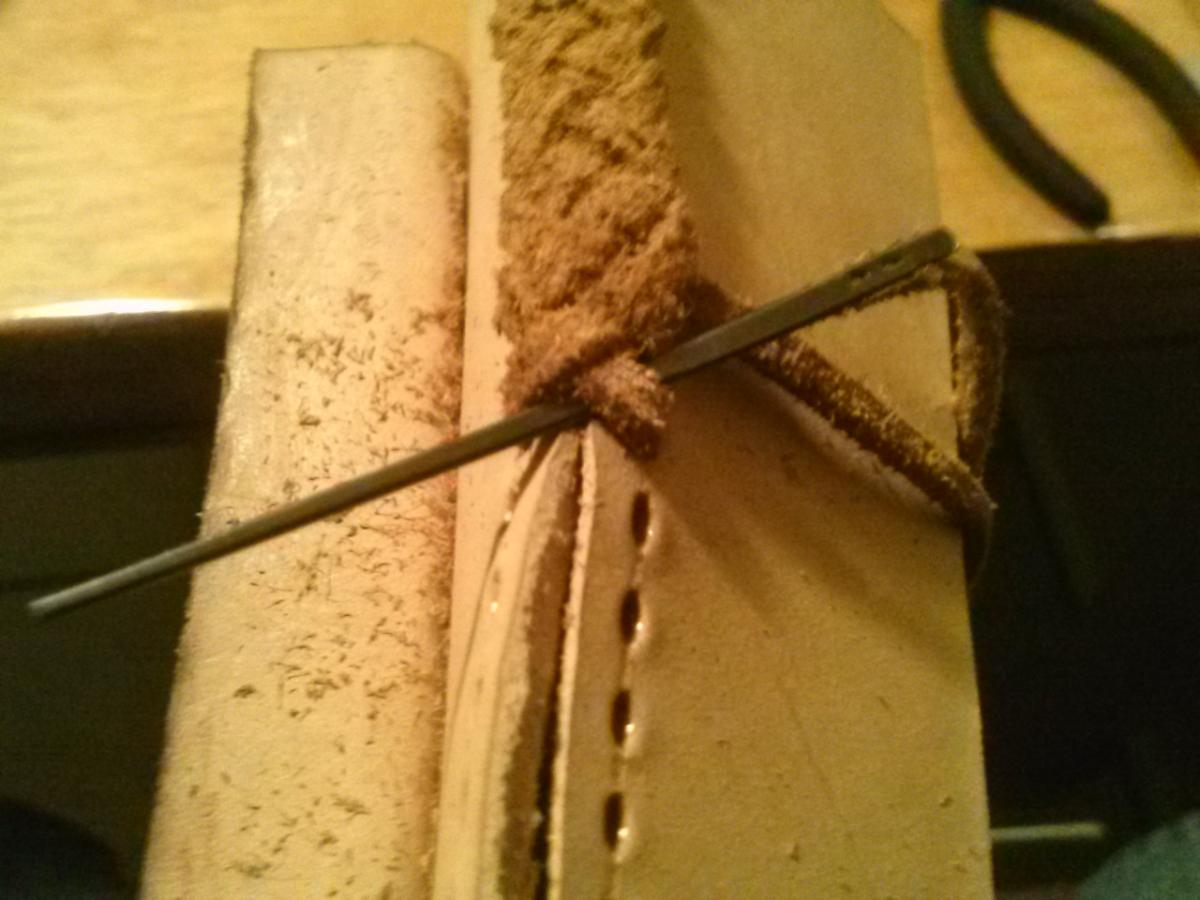

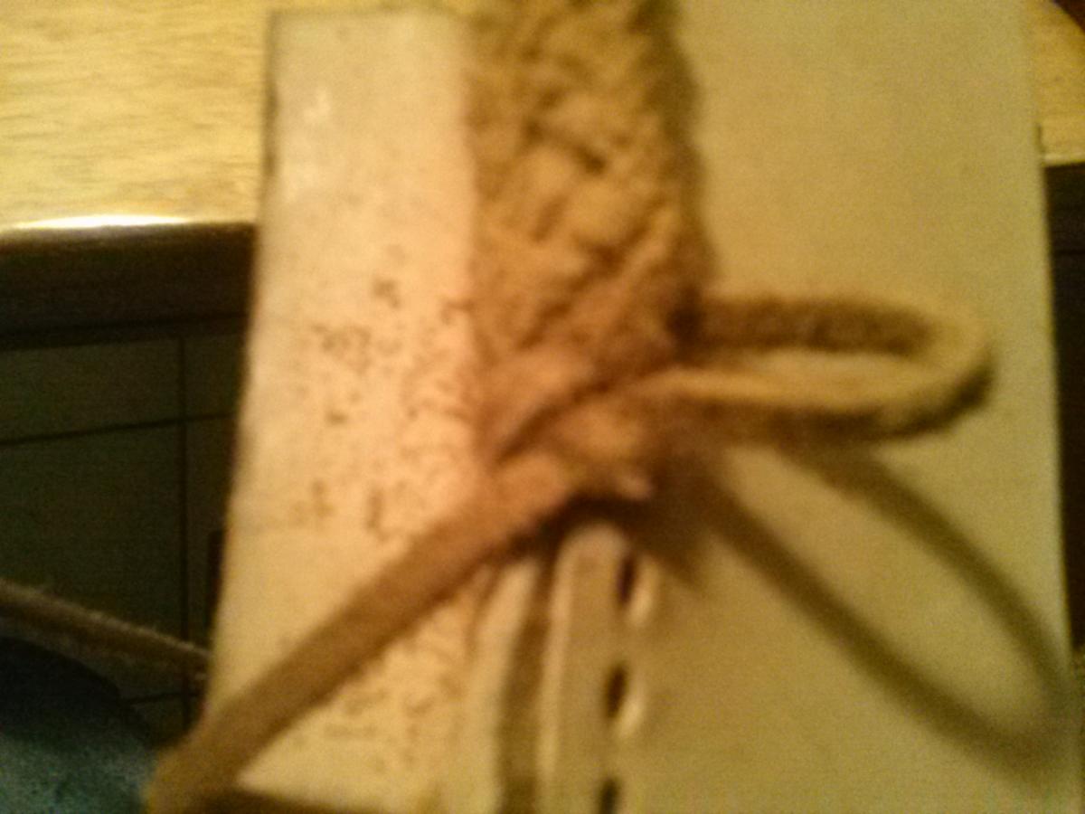

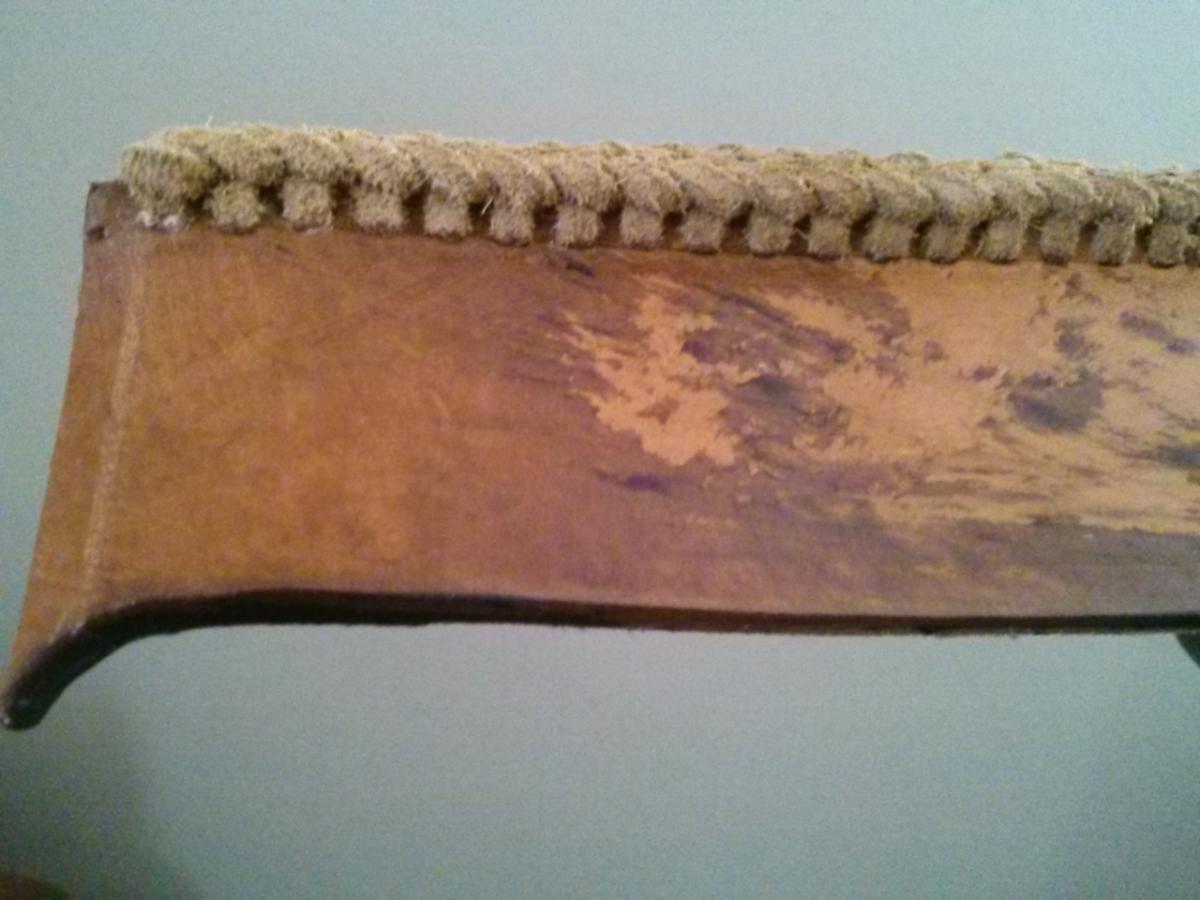

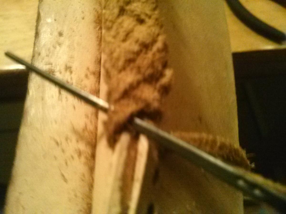

I've attached pictures to demonstrate the stitching sequence...after I've Done a fee to get me going well call the first pic a starting point....go under the last stitch on the backside....next go through the next lace hole from the front, out of the back....lace under previous front stitch...around second stitch back on front side and Beneath all stitches coming out the the.back....around second stitch on backside and under last stitch on back side to come back to our starting point
Going through each hole once....I'll post a pic when I get home....lacing holes were done with a chisel made at work using ss tig filler wire, the tines are 3/32 diameter flattened slightly and double beveled and the spacing rods between tines are 1/8, so laid all together it makes the spacing slightly less than an 1/8 because the two.diameters are slightly offset from the center line from laying flat on the table when I tacked them up
Yeah....between 9 and 10 times length....8 inches or so took about 45 mins using an Awl in slightly undersized holes for a Good lace fit...is there anywhere i could find more info on it that you know of?

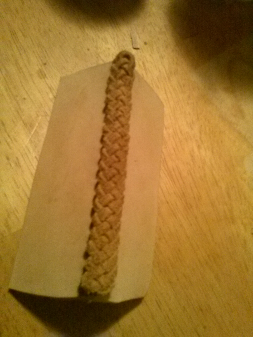

I stumbled upon this edge.braid whilst experimenting with a round lace doing a double loop stitch. I was just looking for something that would cover more of the edge and came up with this on my own. not sure what it's called or how it should be properly started on an open edge, stopped on an open edge or spliced (think I may have the splicing worked out, have to rest), but if someone can identify it for me, id be grateful....its similiar to a triple loop, but instead off just coming out of the back and crossing over and going through the front of the previous bite, you come out of the back, weave under the last stitch on the front, over the second to last stitch on.the front and under the bite (which is four strands wide and forms two crosses next to each other), out the back over the second to last stitch on the back and under The last stitch on the back,proceed to go into next hole on front side.....complicated to explain... Ill take pictures if need be, hopefully someone knows what it is

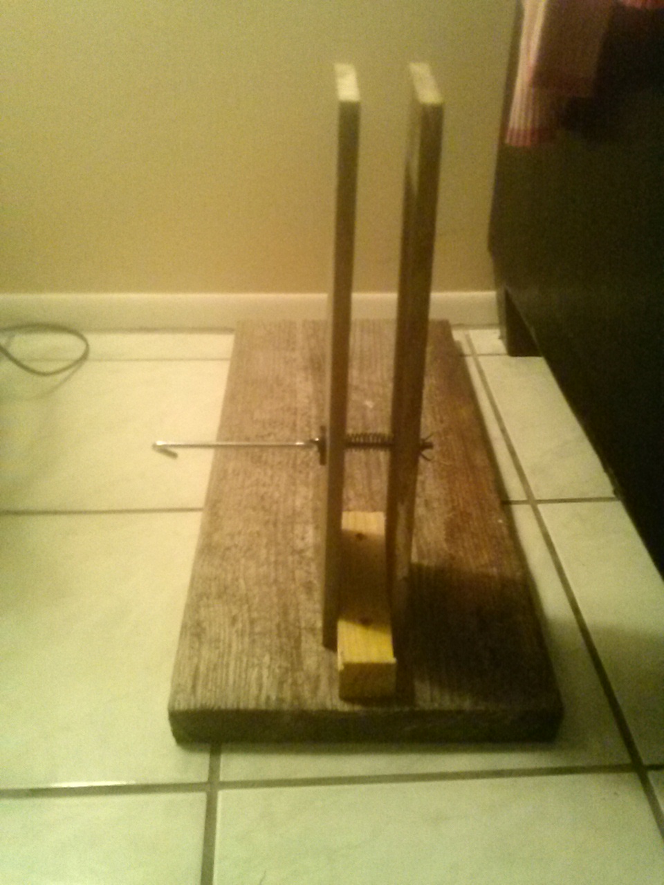

White trash stitching pony I made in less than half an hour including the time spent going to the auto parts store to get a spring and the car battery clamps with wing nuts....total cost: $8.59....wood was scrap fence slats, a piece of 2x4 cut in half lengthwise and a big chunk of 2x12
