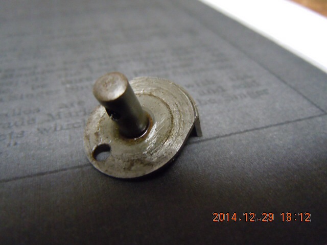

My new shuttle carrier (82177), an engraved Singer part, arrived today and I installed it straight away. To my delight the machine sewed beautifully with no more broken threads. I did have to do a minor adjustment to thread tension but that was all. Attached are photos of the old shuttle carrier, where you will note that the dome on the shuttle carrier spring is worn a bit flat and there are some ridges on the underside of the carrier as well. I am very happy as the next step was to take it to a sewing machine mechanic. The cost was around AUD 52-00 for the new part. Hope this post may help others that have threads breaking in the shuttle area.

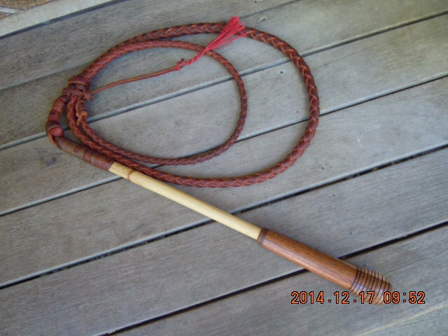

My grandson who is ten years old, asked if I could make him a whip. I have not made a whip for about 25 years and only had an old hide that was around 40 years old. So I went down to the workshop and came up with the article photographed below. It is only a four strand whip and the handle is made of Toheti cane. To add a bit of extra weight to the handle for balance purposes, I turned a hardwood hand grip on my wood lathe, drilled in out and glued it over the handle. He is learning to crack it but gets frustrated. I told him it is all to do with the wrist action, but he is trying too hard and is yet to master it.

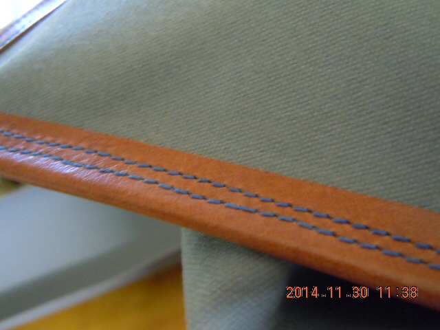

I bought a new shuttle (Towa) for my machine thinking it would improve its performance. The old shuttle sews reasonably well but when I put the new shuttle in, it will not sew an inch. As you can see in the attached photos the thread breaks in the shuttle area. To say the least, I find it very frustrating. Comparison photos of old and new shuttle are attached plus some stitching done by the old one. I have played with the tension spring on the new shuttle but without success. Even compared shuttle tension by pulling on the old and new shuttle's thread. Any feedback would be greatly appreciated.
