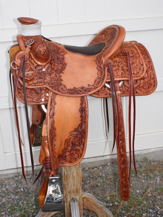

  24. this is a swell fork that after I read the posts about covering without welts a couple of weeks agoI thought I should do it that way.. It had been a while for some reason was in the habit of stitching welts in.... so thanks for the inspiration to get out of my rut also a light wade shortened up for a Arab. > 30lbs
