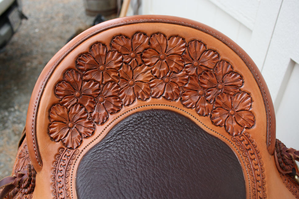

Over all good job. A few areas that I would watch and maybe do differently. Block the rear of your skirts up higher between the bars. This is an area that is really important if you build saddles with longer skirts. The front of the seat above the conchas could be improved. Stitch your cantle binding with 2needles rather than pop stitch. twist your stirrup leathers. You must of had fun stamping the gullet!! Good job of lacing the fork.

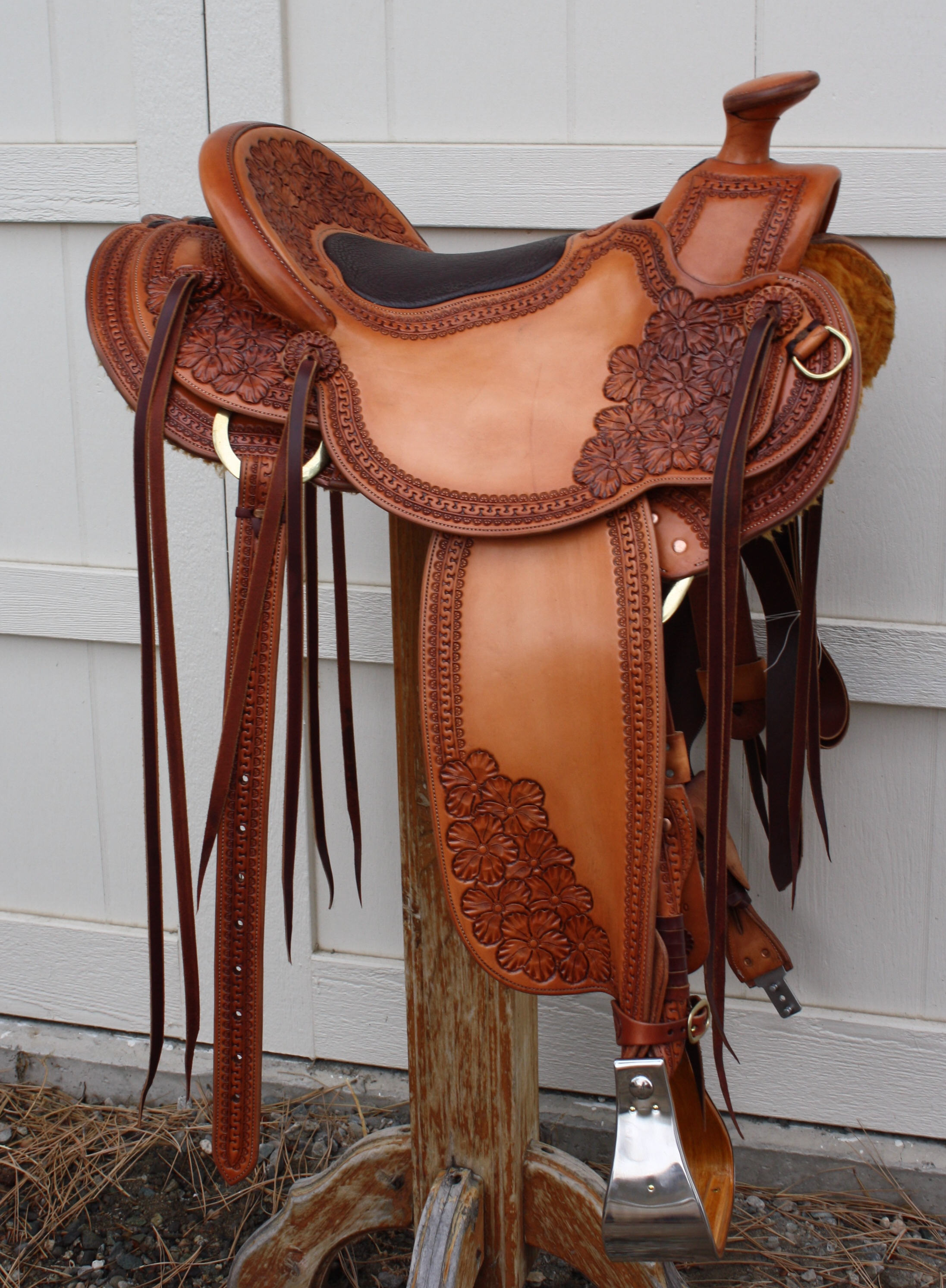

Ialso haven't posted any pics for quite a while so here is one that I built this month... I also built the tree which would probably be called a 3b... The stirrups that are covered and stamped to match are not pictured.
