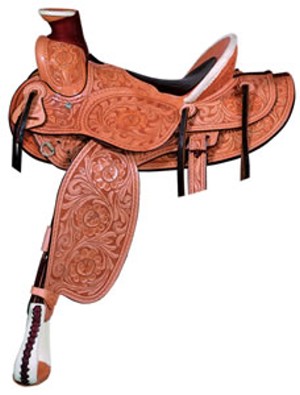

here is a sample of a saddle thet is a wade in name only (poorly designed wade) and what I would consider a true wade. Note the height of the fork of each of these saddles . Both of These saddles could easily have the same amount of wither clearance. Please note that These pictures I just found randomly on the net.
I had to find out what "Stattel" is. ( saddle) Now your question makes sense. True wade trees are designed especially for work saddles where they will be used for roping. This is why they are quite popular with the working cowboys. The horn is usually shaped out of the same piece as the fork. The fork is designed and shaped to put the horn as close to the horses wither as possible. The amount of wood under the horn on a tree built this way may be as little as 3 centimeters. This diminishes the leverage on the tree and therefore the horse considerably (when roping.) In todays saddle market there are hundreds of " wade" saddles that don't have the true characteristic of a proper wade. A lot of tree factorys still haven't figured this out. If you order a wade from a reputable saddle maker that uses true handmade trees you should have a true wade.
