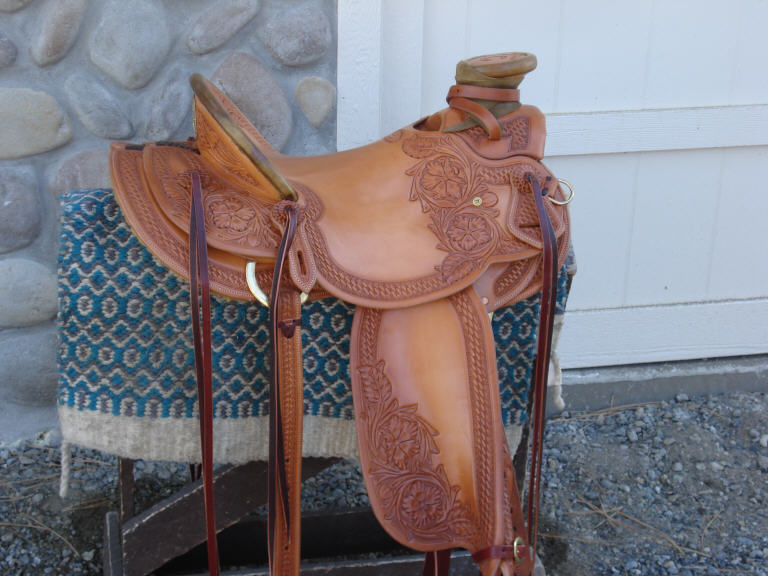

I would make my frog leather and crupper 'D' all one piece. It will look cleaner and lay flatter. Also if when you do your ground seat and hand hole you can leave some ground seat leather on the back of the fork to get a nicer look. These are my preferences, not what is right or wrong. over all looks good. I will try an attach a pic to show what I mean. The other point I may look at is . cutting the front of the skirt a little higher at the front where it meets the gullet. Maybe 1/2". That is also personal preference. But look at other wades and you may see that. Andy

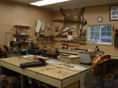

Thought some of you may want to see a couple of pics of my new shop . I have been setting it up the past few days. Still have to move the clicker. I have been building the house and shop for the past 16 months between saddles.. My tree shop still needs lots of organizing. The tree shop is 22x 24 and the saddle shop is the same size. Just a dividing wall between them. The shop is heated with radiant heat in the floors. 10' 6" ceilings. I have to put in an air exchanger yet. I finally have a cutting table that I can walk all around. I just built the small work tool station on casters so that I can have it right at the saddle that I am working on. It is between the saddle stands. I am wanting to buy new cutting surfaces for the benches as well as the cutting table.The benches all have 1" thick plywood so they are solid!!
