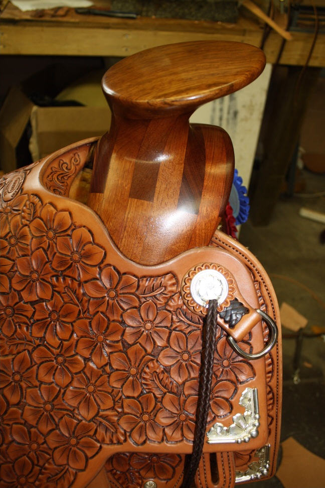

  13. here is the first runner up
  14. Thanks, yes The bars are covered with glass and epoxy. Andy
  15. saddle strings by Beatrice Schafroth :
  16. Here is the saddle that won the Art of the west show in Kamloops BC. Ryan Cope recieved 2nd runner up with a great saddle. Will try and get better pics later. Darcy Sorry you didn't make it... The outcome may have been different.!! Chuck Stormes judged this competition and it was great to have him go over the saddles with the individual entrants.
