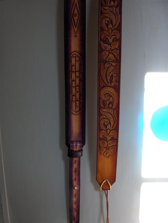

Don't go makin' it purple Mike....That's just my photography. In reality it's a tan base med brown edge, with red over the edge that meets (brown to red to tan) Just a different stab at a different color starburst. That adjusting strap I came up with thirty years ago (not with the rifle sling button), it's okay, but I prefer to make it to the exact sizes, but like you, the shop owner says ADJ. is what they want. And I got a definite no to the Vintage style (thin strap through a padded shoulder), like you been making lately. I dunno why he said that, but I just do what I'm told...
I used a Tan Antique at first. then an Antique Brown over that to darken the highlights. Then I used a plain Med. Brown Dye over the edge for the sunburst effect. I've matched it up to several tobacco sunburst guitars, and it fits right fine.
35 years later I tried carving again. Sheesh I have a looong way to go, but at least I felt like I accomplished an overall look, with the tobacco sunburst effect ...it hid the carving well...lol The other was my attempt at basket weaving by hand...just trying it by carving, without the stamping. Sometimes it looks like brick, sometimes like a weave, I can't tell. Just putzing around until the skills come back into muscle memory. I may have to be reincarnated first...lol

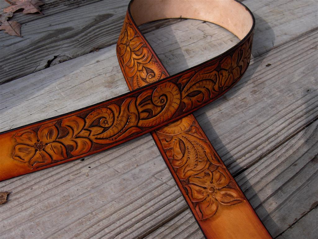

And people think these things are just gitar straps...sheesh You are absolutely right, there is a huge range in options. Not to mention specifically designed straps for mandolins, and banjos.... From a plain 2" strap with 2 holes and some latigo stips to exotic leathers and skins inlaid, backed, unbacked, lace, stictched, hardware, no hardware....the list goes on. Although Designs (carving, stamping, molding), and Shapes (straight, curved, ergonomic) can be limitless, I find the methods for adjustment are limited, and that frustrates me. One of the old books I have (c1800s) had a hook and eye made from heavy leather, that got my inventive juices going And then the customers come in with their ideas...... I look forward toward to your new pieces, they are inspirational...

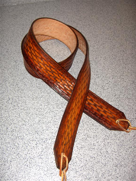

After seeing Mike's Basketweave, which was awesome, I thought I might try something. At the shop I sell my straps, there was a "sunburst" electric gitar, I wanted to match colors to. I'm too rusty to match anyone's skills here, but just to dip my toes I combined the sunburst idea with a basketweave. I "stretched" the weave, it's not easy to line up that way, there's a few mistakes if you look close, but overall the whole thing gave me the sortof effect I was looking for. Antique tan as the base. Med. brown dye along the edges, with a hint of black along the very edge. I applied the brown, and black with just a cloth, rubbed very well off on the back of scrap leather, until almost dry, then lightly rubbed it on the strap...not great, but overall, not bad. What do You think?
