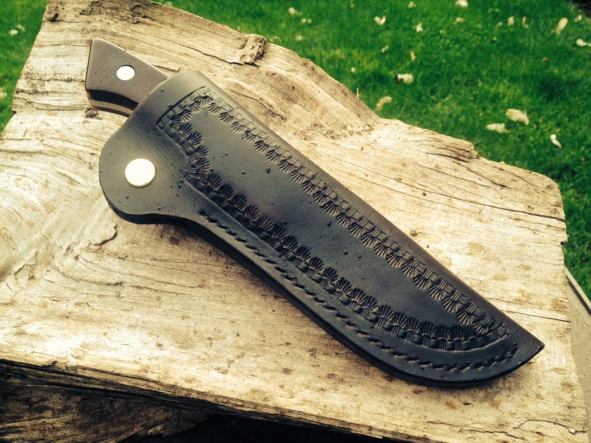

Made this a few months ago, its 9 oz. veg with a welt. The knife handle is wide in one area with a deeper finger groove and since I don't particularly care for straps, I opted for a snap to lock the knife into the sheath at the groove. It's very secure, the knife locks in snugly and won't slide out. I haven't any tooling experience but thought I'd at least give it a go. I think its adds a little to the overall appearance. It is a found knife that was in rough condition before I cleaned it up and honed it to shaving sharp condition. I screwed up using too large an awl as the 1mm saddle stitching looks small comparatively, it wasn't made for a customer so I'll live with it until I do something else with it. Opinions and critiques always welcome, thanks for looking. Regards, N.A.T.
