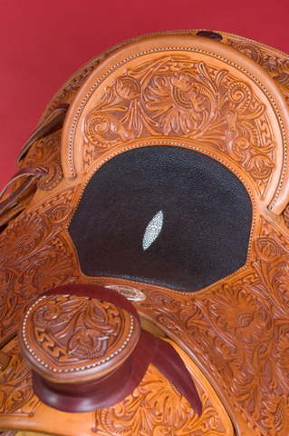

Ryan, I made the holes by hand, and sewed seat on my machine. And, at this point, I'd say you need to get a few under your belt before you begin to figure out how to do an inlaid stingray seat. Keep in mind that nobody has ever shown me how to do an inlaid seat in general. This is my second stingray. The first was last month to practice for this one. I had another guy ask if I'd sewn it by hand. He looked at me as if I was either crazy or ignorant when I said that I did it on my machine. Probably the latter. My interaction with other saddlemakers, before I joined this site last Thanksgiving, was almost zero. Also, I would suggest using a thinner pan than normal, and replacing that with a peice of 3 oz. strap. There is probably a few more experienced guys on this site that could help me out with that. Ryan Cope
