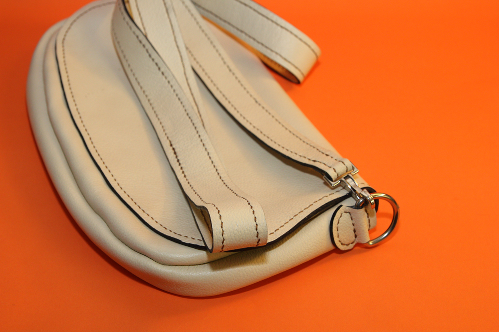

Tandy has a sale on some finished whole hides if you can find a colour you might like. I managed to pick up a 40 sq ft hide in cream and a 42 sq ft hide in dark brown for $45 a piece. Here's a bag I'm working on, I just don't know what I'm gonna do yet for the shoulder strap. If you want to do more with this type of leather I recommend watching Arthur Porter's videos on youtube. I've learned a lot from his videos. -
