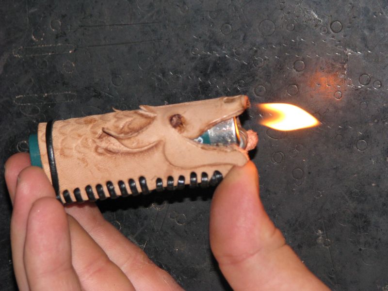

  3. Well, it said "Fire Breathing Dragon(s)" in the topic description.....here ya go: Since we were limited to just 5 tools....the eye sockets are still empty for the purposes of following the rules. They'll have some nice little copper balls epoxied in there. Swivel knife, mule foot, snap blade razor, deer foot modeling tool, lacing nipper/punch. Just to be a stickler to the rules I ran the lacing with out a needle........well, mostly because I can't find my lacing needles, but still..

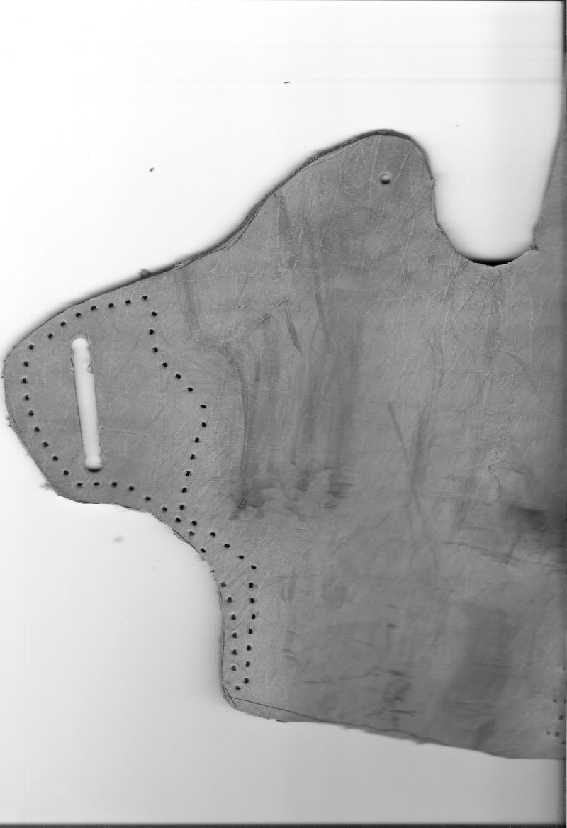

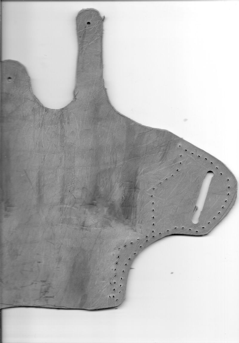

  6. Here it is: This is a scan of the actual leather, converted to gray scale. Using Ifranview, you'll need to select "fit to page", and it should print out actual size. I didn't include the belt slot, but it's pretty easy to figure out. Print out, line up the edges and tape it together for the complete pattern. NOTE: This is a ROUGH PATTERN.....tweak as needed. I also recommend cutting the leather at least 1/4 inch outside the pattern so you'll have room for compensating differences in leather thickness, etc., etc. Length of the thumb strap is pretty close. This pattern is for a 'rough-out' holster so if you want grain side out, don't forget to reverse the pattern on the leather.
