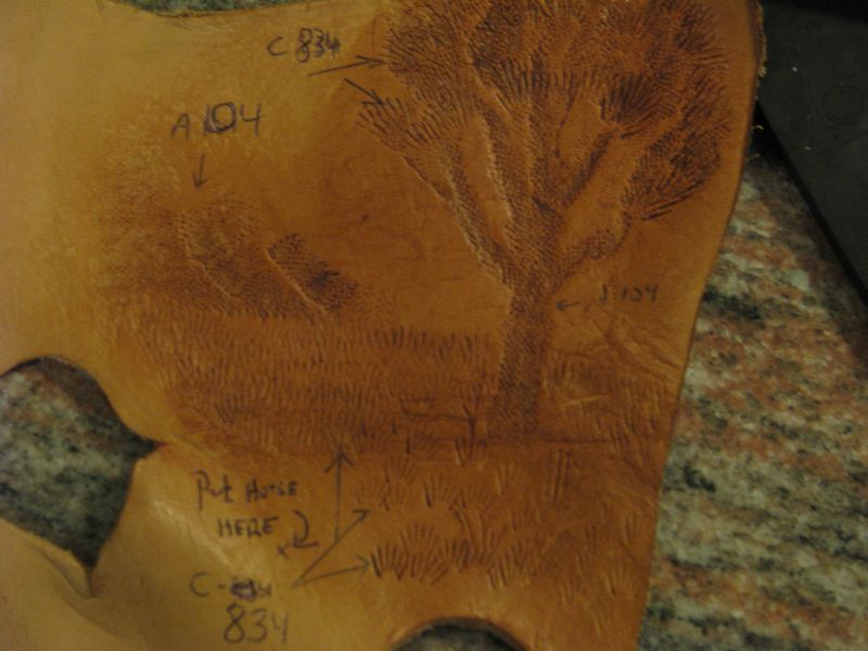

One thing to keep in mind....you are LEARNING. If you choose to not do this with the current piece, just tuck the info away for use on another project. Here's an example of a 2 tool background. The C834 is used (though you can do the same thing with a camo tool) with many light, overlapping strikes to give a 'choppy' appearance for the 'meadow' in the center of the piece. Full strikes are used in the tree to suggest some foliage, and in the foreground for 'clumps' of grass. There's also one or two places where I drug the tool to suggest some longer reeds. The A104 (small backgrounder) is used for the mountains in the way-back background and for the trunk/branches of the tree. Nothing is actually drawn with 'hard' lines. Instead the piece uses shading/backgrounding and especially varying depth of the tooling, to make the image. If you don't have a backgrounding tool, you can make one out of a stick/dowel. Just take it outside and 'stamp' it on a sidewalk. The concrete is a rough enough texture to give you some pattern and is hard enough to imprint the softer wood, making a negative image of the concrete on the end of the wood. Anyway, here's the pic: P.S. I antiqued it to give it a little more definition for the picture.
I meant that the tree should be between the horse and the hill.....visually. And I was mentioning using a backgrounder to create a pointillist type image where you have the image, but you've actually drawn no lines. I'll whip up something here in a few minutes, and post it...but it'll take a few minutes because after making it, I've got to take the picture and then get my wife's computer to get the image - because I can't find my cheap little camera that I just transfer the memory chip from the camera to my computer. BRB.....

Cheryl, do you know what pointillism is? If so, and you have a backgrounder, stamp in the outlines of a hill in the distance with maybe a tree in the foreground. Use heavier blows from the mallet to set these impressions a bit deeper and likewise with any details like clouds or tree branches. Then fill the areas between - sky has no tooling except for clouds. Meadow has some tooled in tufts of grass. You can do what I call "friction burnishing" by rubbing the face of the leather with a tight weave cloth and a good bit of pressure. You're giving the leather a friction burn, and it will keep the slightly darker color. Use that method to shade the area of the meadow. Use the beveler like a pencil and just drag in some lines suggesting taller grass. The key to doing this in leather is to think in terms of negative space. All the elements of the composition are at the same level...you need to push everything BUT those elements 'back' to make them stand out. You can push the open space back through tooling, color, shading, etc. OR You can pull the elements you want 'forward' by stretching the leather (from the back) to make the elements stand above the surface of the leather- this is done by embossing, the use of lifters, and undercuts.
