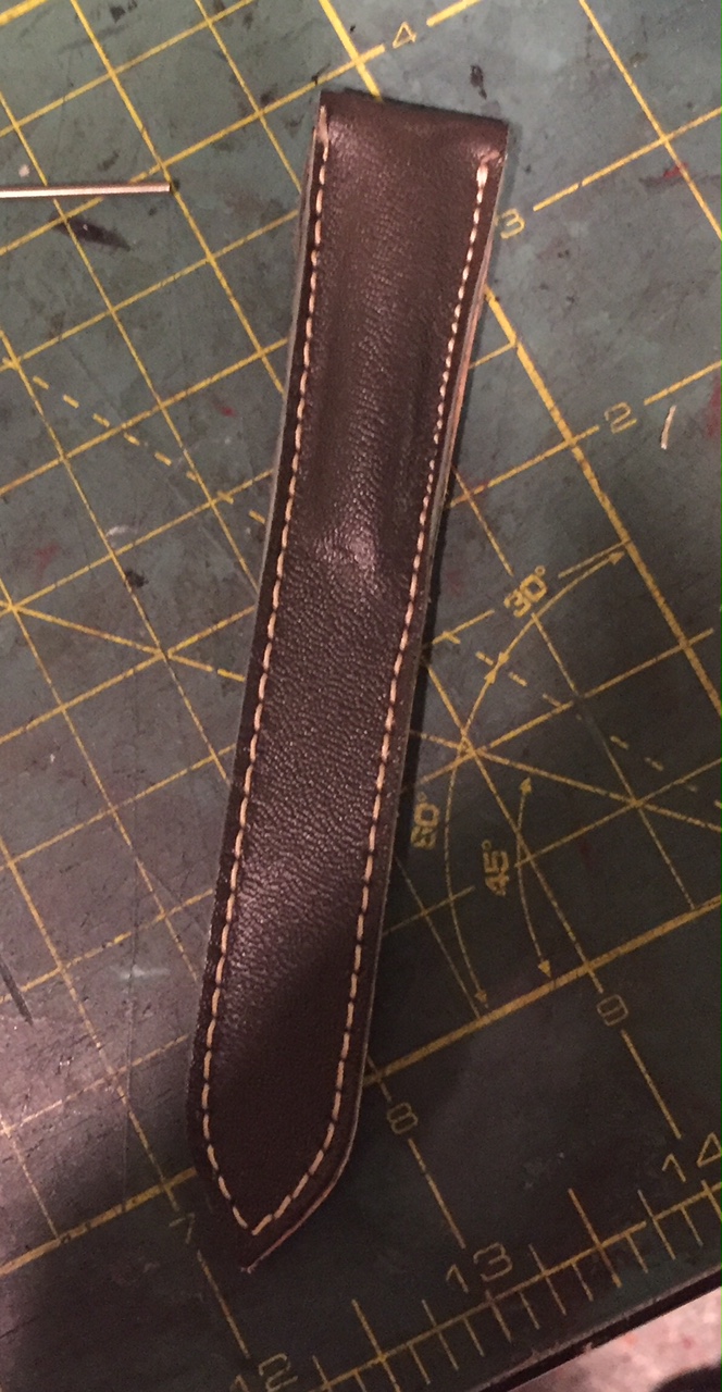

it is a new Techsew 5580RF that they just came out with. The teeth look like fine or medium..the feed dogs are what it came with it is a about and inch or so diamter roller foot here it is on youtube when I just got it -

the roller foot is definitely hitting the padded part and then goes to the flat part and does well....so I think I have set the padding so that the roller only rides on the flat part of the strap so it is consistent..does that make sense? thank you -
I have been using a walking foot for a couple of years now but got a Techsew Roller Foot to get closer to the edge on watch straps and that has been going well with flat straps. I have run into a problem with stitch length with the padded area of watch straps with stitch length. This is with 69 top thread and 46 bobbin. 16 needle and the tension is fine. but when it is on the padded part the stitch length is much shorter than the flat parts even though I do not change any of the settings. here are some pictures any help on what adjustment either in sewing or padding would be appreciated with the leather sewing gurus! thank you Greg
