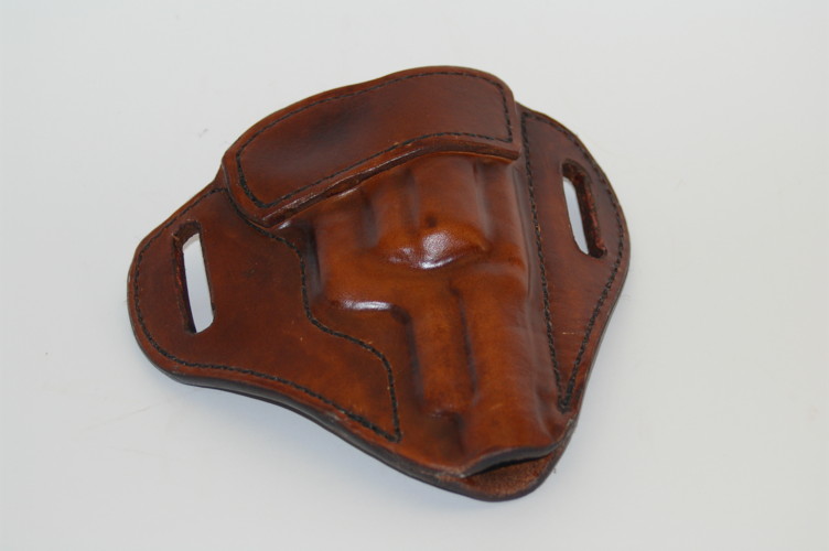

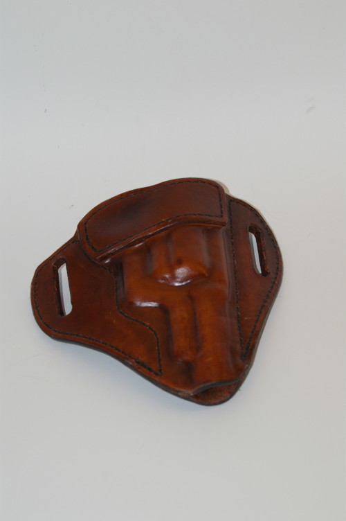

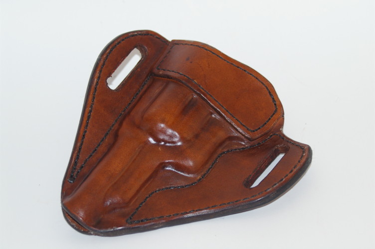

Judge Holster Finished
WaG35 replied to WaG35's topic in Gun Holsters, Rifle Slings and Knife Sheathes
Thank you both very much. Randy- yes revolvers are a little different. I learned a few things that will make the next one much easier. As for the sight channel, I didn't mold one in, but I did take it easy boning that side and the way the holster is built it kind of formed a natural sight channel on it's own. And the judge has a big front sight. -
Well a couple days ago I had posted a holster I was working on for my brother for Christmas. It is Finally done. I did a couple things that I hadn't done before: Used my new drill press to make the stitch holes and sand and burnish the edges, used a brown dye, and hand stitched with a pony I made for myself. Here are the stats. Leather: 7/8 from Zach White Dye: Fiebings Dark Brown oil dye(Airbrushed) Finish: Sheen Stitching: all by hand Boning: Sharpie Burnishing: Felt burnisher and beeswax Let me know what you think. I also made a lightbox for the photography.
