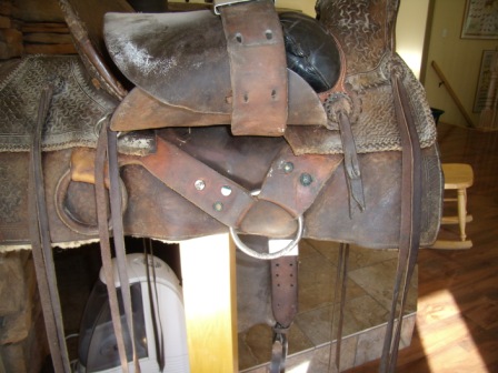

Saddle Identification
Denise replied to richardbessey's topic in Saddle Identification, Restoration & Repair
I agree with Jeff. We have an old saddle sitting in our living room which is in much better shape than that one (it has been worked on since it was rescued), but it won't fit today's bigger horses (or today's bigger people either...) but it is worth having for the historical value and for us, as a discussion piece. But please, fix it up before you put it up for show somewhere! I see these magazines that have "decorated western" with bits of JUNK tack around. Decorators may like the look, but those of us who appreciate good tack don't! It sounds like this one is worth it sentimentally to keep, and that makes it worth the time and effort to make it look good again, even if it won't be usable. -

Neat old saddle! Thanks for posting the pictures. Please let us know what you find out if you do learn more about it.
