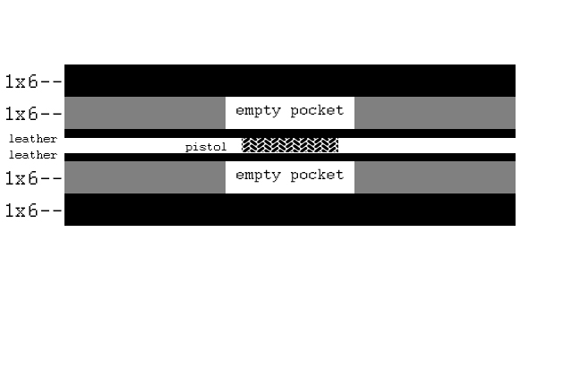

Ken, yep, was planning on cutting the pocket a little larger to accommodate the leather. just forgot to mention that in the idea post. thanks for the tip on the maple.
let's see if I can describe this correctly now. here's what I'm thinking and want to know if it would work. if I take a 1x6, trace around the pistol and cut that out and mount the pieces to another piece of would (doing it twice so the pistol would be in a pocket), then tack the leather to the wood (after wetting and some light stretching) across the pocket area, then place the pistol (that's been placed in a plastic bag) in the pocket area and clamp the whole thing together, would it work?
