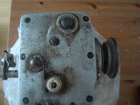

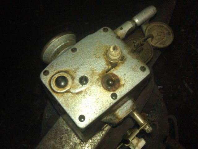

So, it arrived and I did try the coke for about 20 mins.... By covering the machine with a cloth and then soaking it with Coke. It seemed to work, to be honest. However, I was in a hurry and decided to use Kerosene and my girlfriend's exfoliating glove.... oops Before: After: So thank you very much for your suggestions... I have learnt something that I know I will use often. I am really pleased with the results. Cheers Alex

Well this must be the longest thread I have ever had.... Anyway, the machine is stil not here, but when it arrives I really want to try coke... So will try that just for fun and then try Darren's suggestion of wire wool and kerosene..if not then WD40.... Thanks, I have learnt something, which hopefully I can use in the future, because I am sucker for machines I don't need... Cheers Alex

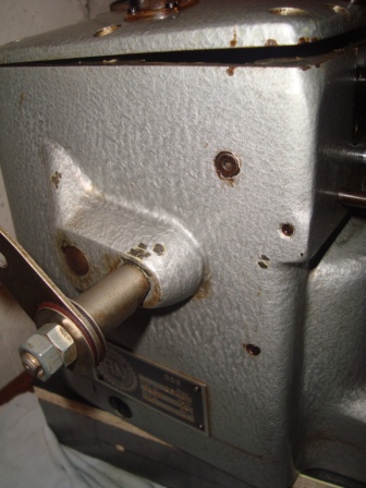

Hello Everyone, Thank you for your responses.... Constab: I still have the Recolor, but it seemed to remove alot of the paint off the Singer 29k. That is the last thing I want to do. I only wish to clean up the outside. Thor: I will try Waschbenzin, after the WD40. That's a new word for me to learn... Uwe: Thanks for advice, I will look out for it over here in Germany. I have to wokr in my cellar, so anythin that doesn't stink is a bonus. The most important thing for me is that I don't damage the paint that is already there... I only want to remove the old crud and hopefully the rust. Cheers Alex
Hello again, Thor I will give the WD40 a go first and post the results... I am not really very experienced at doing refurbishments...I have accidently removed decals on several onld machines... Much to my disappointment, Luckily, this one has nothing fancy on it and just needs a good clean. Do you think the rust stains will come out of the paint? Cheers Alex

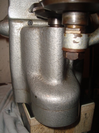

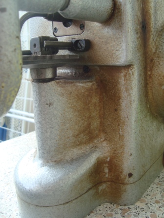

I have clean up old sewing machines before in a very amateur way, because I never really care about how it looks... However, this time I would like to keep the pain on and do as little damage to the original finish as possible. On other machines I have used, rubbing alcohol/ turpentine, alcohol (ethonal) and acetone. All damaged the original finish. The pictures below is the machine I wish to clean. Thanks for ay advice.... Alex
