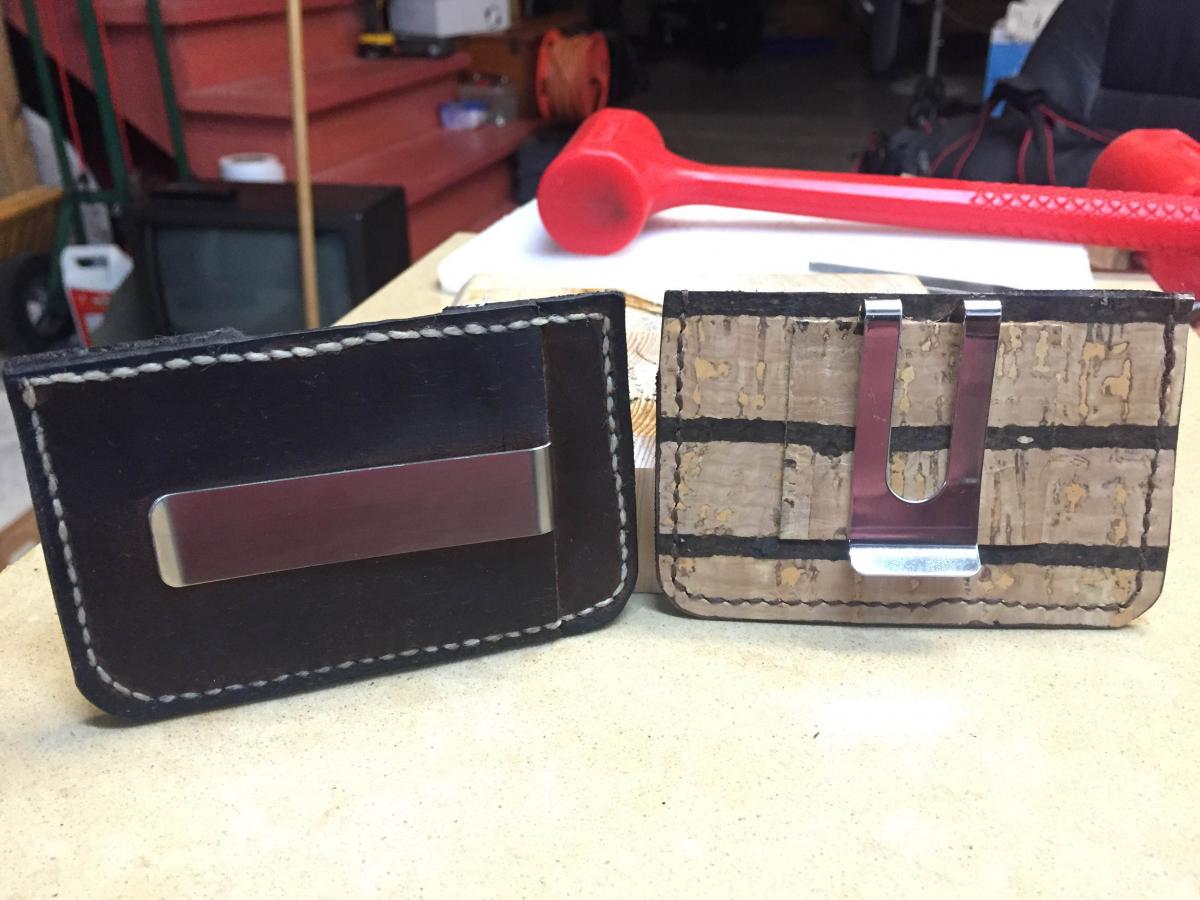

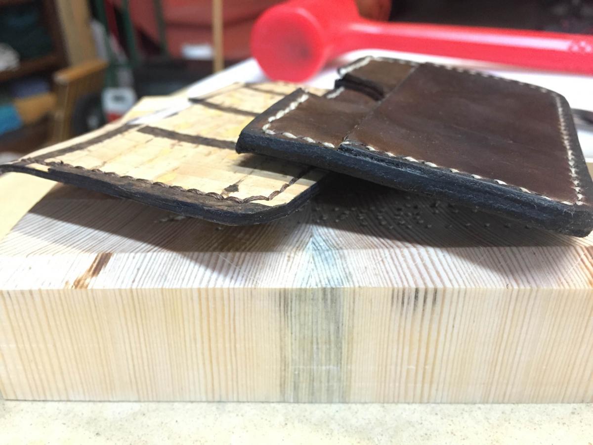

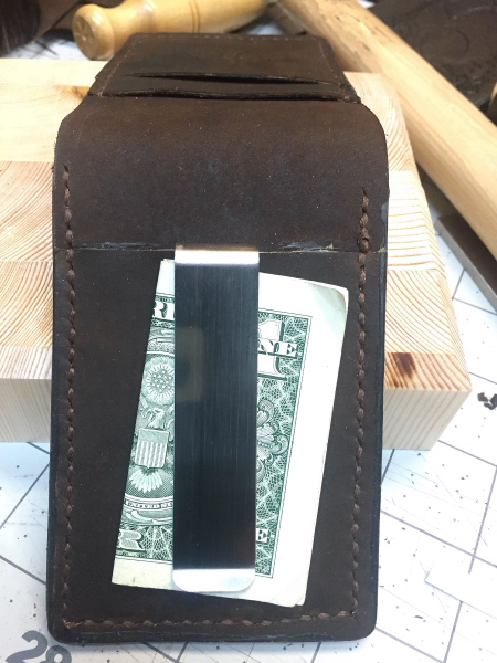

I've been working on some card wallets recently, hoping to improve my stitching in particular. I have also been trying some different materials. I like the wallets for practice as the loss of material when I screw up isn't as significant as some other projects. The dark brown leather in these is Horween tobacco chamois. The light tan is actually cork fabric which I picked up recently. It is nice to work with and is supposed to wear very well. (Time will tell).

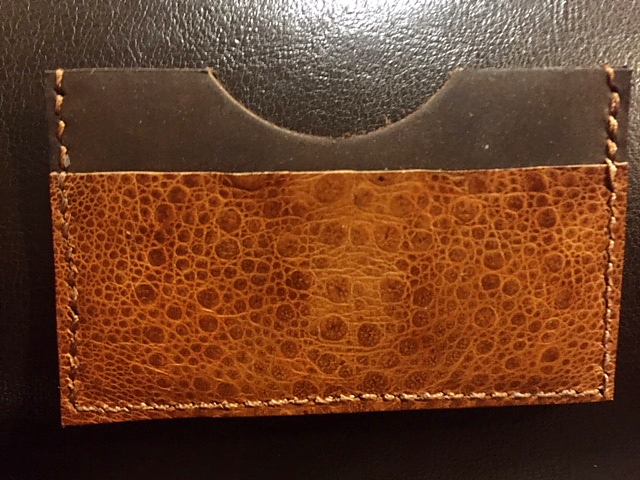

Thank you all for the kind words. The hides are $12-$14 each from what I've found in the US. The ones I have are pretty small with an irregular shape. It took two hides to make this piece. -
Center pocket is made from some Horween Tobacco chamois scrap that I picked up from a member here. The outer pockets are cane toad. The hides were very small leaving me few options. The center pocket is a little tight - I imagine it will stretch a bit with use. Can carry four cards easily, perhaps six with some stretch. Still working on my hand stitching. More even on this go around, but still a long way to go. MJP

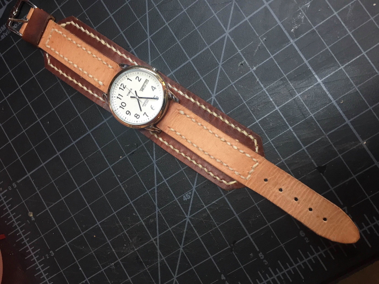

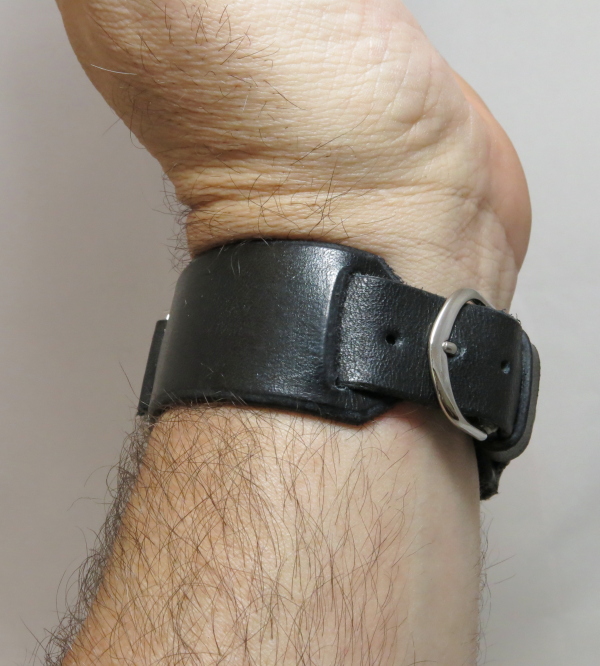

So the straps holding watch are cut from the main strap and tucked under? -

I'm using a stitching chisel to mark it, but not drive it all the way through. I'm using a diamond awl to make the slits. -

Thank you. I did not use a groover, I used a creaser to provide the stitching line. I will give the hammer a try. Had to look up "bund strap" - I'm very new to this. The first strap I tried I think is in that style as well. I liked it for it's simplicity, but I really messed up cutting the slots. -

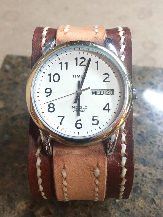

I finished this strap this evening. It's the first of the three I've tried that I really like- (even with the errors - and noticing that the date on my watch needs to be set). Veg tan with lambskin lining. Saddle tan base and neatsfoot oil only top strap. I think I'm getting better with my edges and stitching, but there is still quite a long way to go.

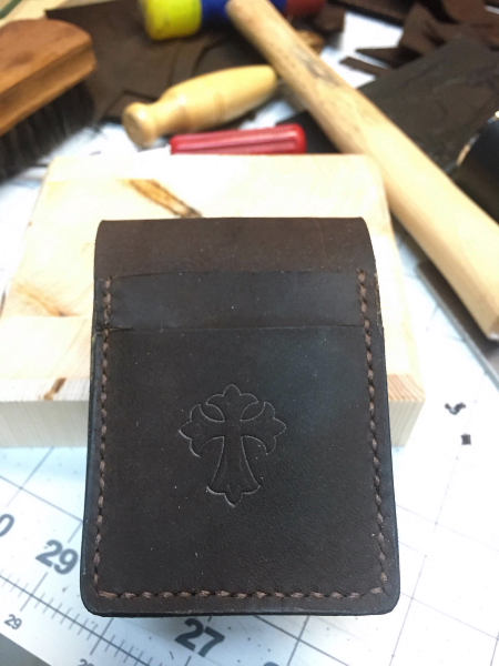

I've been trying several different projects since picking up this new hobby earlier this year, working my way up to some big projects I want to try like holsters and bags. One item I've been working on is an iPhone case. Of the five I've made this is my favorite so far. There is still so much to learn and improve on, but I think I'm making progress - in no small part due to the excellent information I've found here. I chose the clip as this is my work phone which I remove frequently throughout the day when I'm at my desk. I've had good luck with the retention type clip. A couple of questions - 1) I managed to put a knick in the corner of the face of the case. I tried to smooth it but was worried I would make it even worse. Can this be sanded out and touched up? 2) Any tips on how to remove a blood drop stain before dying the piece? I tried saddle soap and alcohol without much success.
