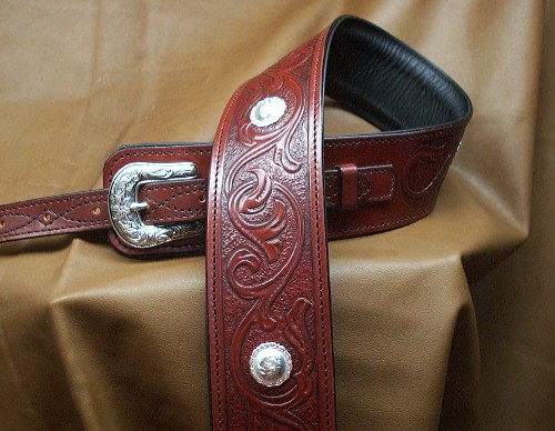

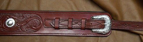

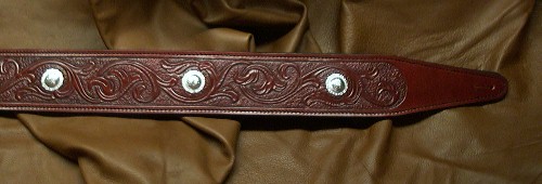

Finished this one today. I need to find another buckle, but put this one on for the picture. I'm loving the way this color turned out. It is actually British Tan that I sprayed on too heavily, so it's more like a Chinese Red. I'll be using that again for sure.
