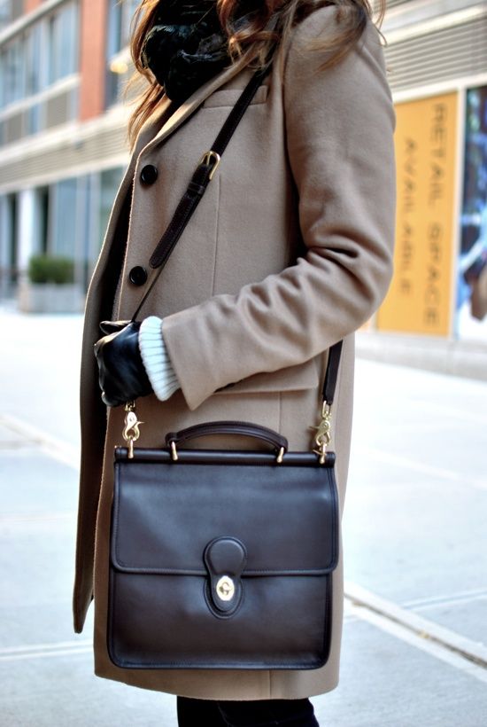

This is incredibly helpful and the photo examples are beautiful. Thanks for sharing your work and experience! I like the idea of attaching the dee rings to the back, but in that case I would have to use a chain strap, which I wouldn't want to do. For the closure, I was thinking a simple turnlock. I found an example of a bag similar to your second example in a way, but where the dee rings pierce the front and back at the top of the bag. This is a little more complicated visually, but I like the idea. Thanks again for your advice--I'm going to keep mulling this over.
This would be an everyday purse. Medium in size--around 12" wide by 9" high by 3" deep or so. No books, just everyday carry type stuff (wallet, phone, keys, sunglasses, small odds-and-ends pouch) plus a 12-ounce bottle of water.
I want to make a flap-style shoulder bag, but unlike the bags where the strap attaches to the gusset, I want a single loop strap attached to the top of the bag. It would be modeled (in style, not in craftsmanship!) on the Hermes Constance (pictured), where the simple strap can either be doubled up to wear on the shoulder or worn at a single thickness messenger-style. I've never owned any bag like this, much less a Constance, and I was wondering if there are any particular aspects of the construction I need to keep in mind to be sure the bag does not tip over when it is opened while being carried, for example. It also seems like the clasp would have to be fairly strong to handle the stress of the way the bag would be carried--but maybe I'm overthinking this? I know that messenger bags with a top handle usually have a reinforcing strip on the inside of the bag under the handle, so I would definitely do that, but was just wondering if there's anything else I'm overlooking. I'll prototype first, but still want to try to think it through as much as I can before getting started on the pattern/design.
