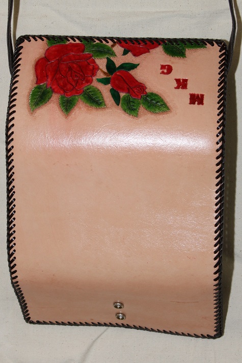

Thanks Syl, They are a basket weave applique (not sure of the spelling), I didn't take a good picture of the braid, next time I do it I'll get a better picture, this one shows some of the braid, the other end matches this end. Ken
