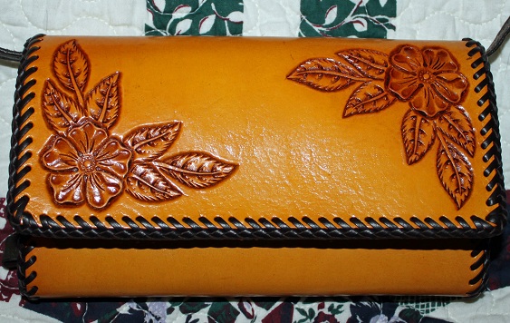

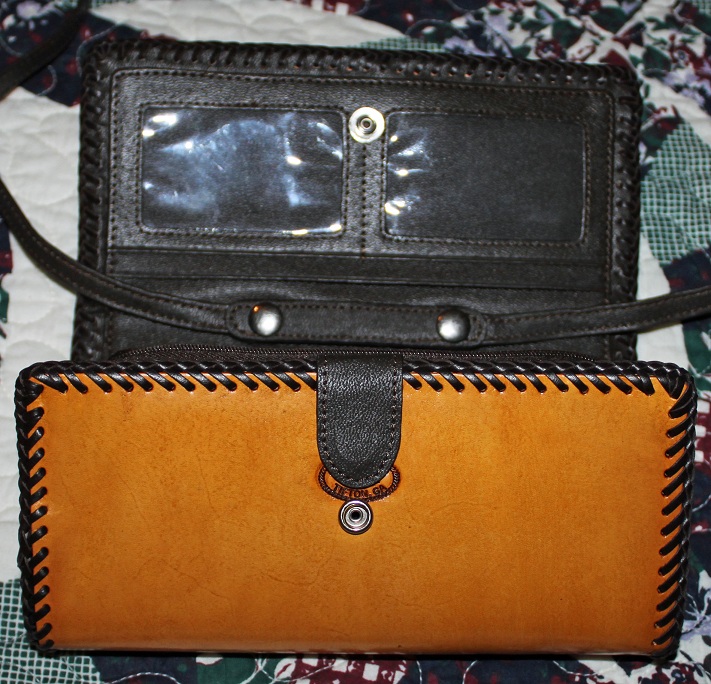

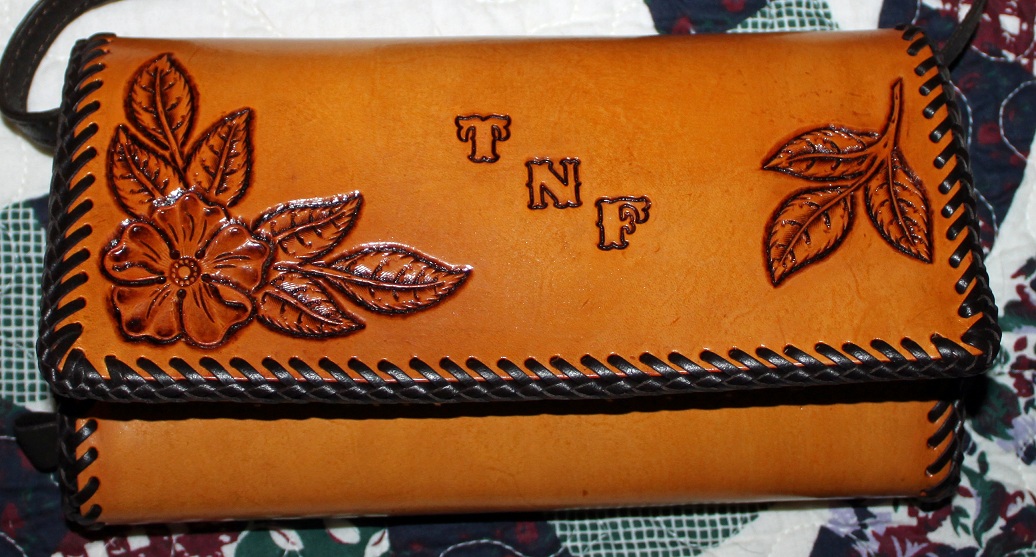

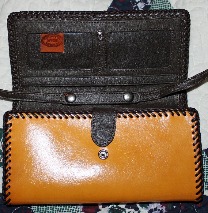

Clutch Purse With Strap
Chief31794 replied to Chief31794's topic in Purses, Wallets, Belts and Miscellaneous Pocket Items
Sherlockian, Thanks for the nice comments, I'm working hard to improve the carving, it's coming some but slow. I have a long way to go. Ken -
Coasters work well for beginner children's classes, let them stamp their name on the coaster they get the feel of pounding leather, make a useful item they can give their moms. Doesn't require a lot of tools, one mallet, one set of alphabetic stamps, water, a small bag of wool daubers, small bottle of water based dye so it comes off them easier, small bottle of super sheen, and prepunched coasters, Tandy sells them in large project packages. Ken
Thanks, I don't make my own interiors yet, that is another whole ball of wax for me. I did add a sewing machine to sew light leathers to go along with my Boss. I would like to make them but so many things inside, zippered pockets, id windows, etc. This one is a Tandy Kit, I buy some interiors from Tandy and put my own backs on them but Tandy doesn't sell this inside with the strap. I would love to find a good source for them as well. Ken -
