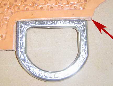

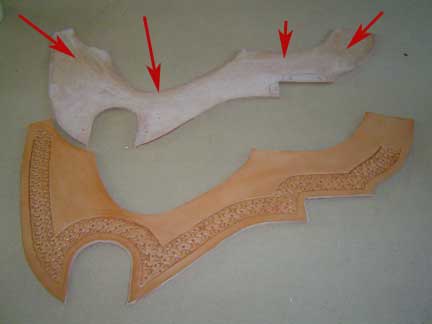

Hello All, I am having a really hard time on my first saddle getting past the rigging. My first mistake was cutting out the rigging pieces and then the lining and trying to get them to match 100%. But, I have what I have and need to move forward. I have a few questions: 1) I have excess in the rear beside my back rigging plate. What would be best to do with it? It is too small of a hangover to be able to glue down I would guess (see pic) 2) On the lining piece I was told to skife down the tops of the lining where the rigging connects to the tree - (see pic) I did that, but on the inside of the lining (see pic) Does it matter inside or tree side? Did I do it in the correct places? Should the top of the rigging piece that is tooled also be skifed? 3) I know this is boardering on perfection - but what should the BACK of the lining look like if the rigging plate is in correctly? Mine has a little bit of a gap in the corner. Due to my initial problems, the rigging piece doesn't sit up against the cantle as I would like - it isn't bad, but next time will be better - any comments, instruction, HELP would be much appreciated! Charlene
