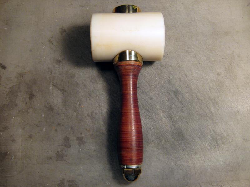

Here is a Barry King 64Oz Mallet in like new condition. Just what you need to drive those larger mallet dies. Asking $50 which includes shipping in the CONUS.
