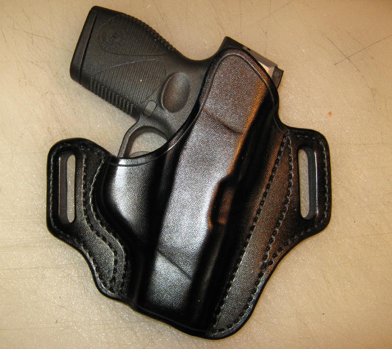

Brian It looks just like an oversized bag punch. I got mine from Texas Custom Die. They will make you about any size you want and they make custom clicker dies. The one I used for these holsters cuts a slot 1&9/16 tall and 3/8 wide. Just google Texas Custom Die. I drive these with a 4lb maul and after I reground and sharpened them I can go through two layers of 8/9 Oz with one or two whacks. That is one Caveat TCD seems set on grinding them like bag punches which leaves too steep a shoulder to go through two layers of heavy leather. Eric (Particle) had the same problem with his set.
I use a mallet die to cut the belt slots. Kind of like a bag punch on steroids.
Thanks guys for all the positive comments. To answer some of the questions. That line around the mouth and bottom of the holster is just the continuation of the stitch groove. The LC9 shipped to dealers on the last Friday in January. I got one of the first ones. This is going to be a hot one for holsters guys. Ruger hit a home run. On the black dye. I cheated. I use Hermann Oak drumm dyed leather because it will not bleed out the dye.
I haven't posted anything for awhile. Here are three of the current crop for the Ruger LC9, HK P7 PSP and Taurus PT709. All are Hermann Oak 8OZ.
