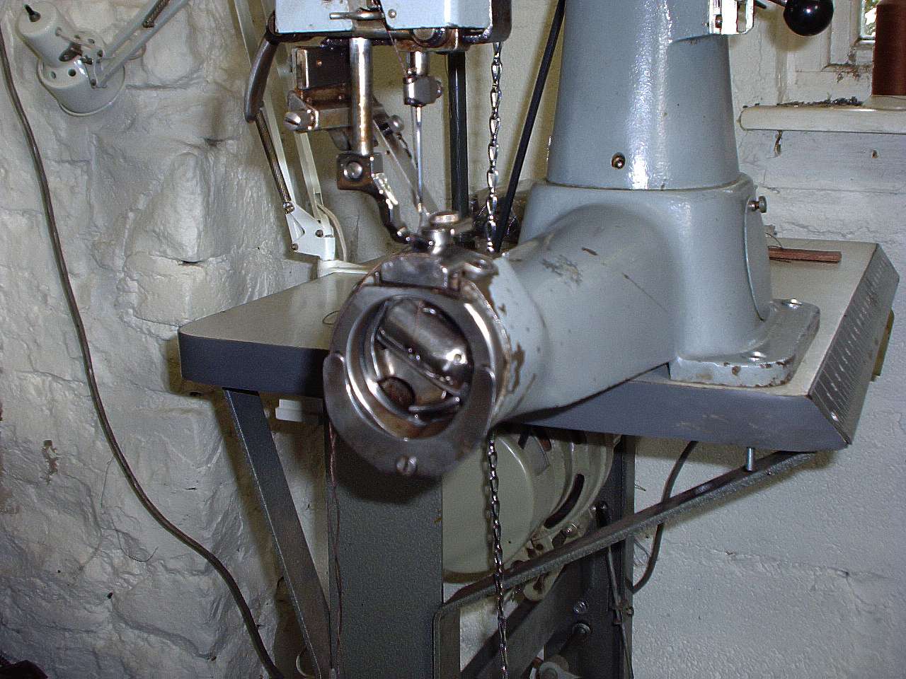

Interesting looking machine, I've not seen anything quite like that before. What's the function of the mechanism to the right of the post? All of the post machines that I have seen do not have anything like that, just a plain post. I'd have thought that you'd find this machine quite useful, particularly for stitching inside light weight leather bags and such. Steve

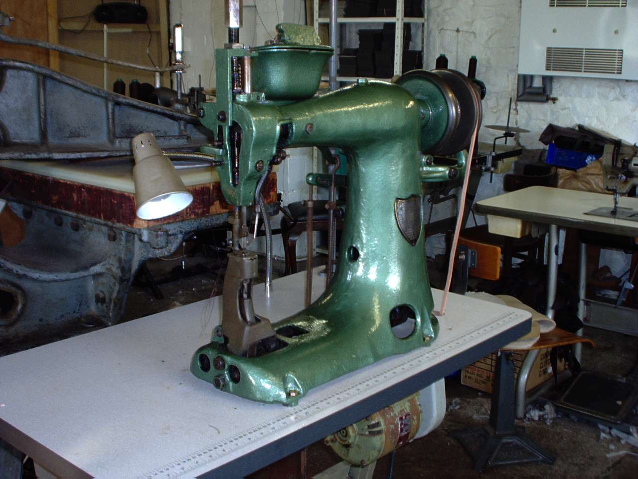

I, for one, would certainly be interested in seeing a pic of your machine. It sounds a bit like the Highlead GC24618, although that has needle feed as well as top and bottom driven, roller feeds. Steve
I, occasionally, use a three row Puritan for certain jobs, you have to be careful when finishing off a seam, as there is no reverse feed and you must be very careful when removing the work from the machine, as you can easily unravel the whole seam! The only real advantage, other than the multiple row system, is that the machines will sew through very thick materials, including Plywood and thin Aluminium (Aluminum), not that I have ever tried that! Steve
