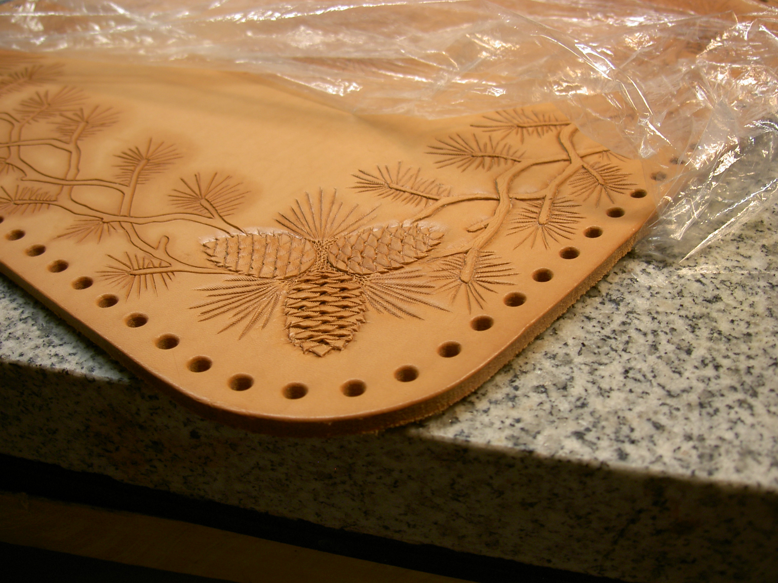

  2. I have a very large collection of Tandy tools that were purchased over many years, some fairly new. Never had one bend or break on me. May want to try and get more moisture in your leather before stamping so it will take the impression without having to hit it so hard. This seems to be the most difficult part of carving and tooling for noobies. Try to find some scrap leather to practice getting it cased properly to take the impression with less effort, careful not to get it so wet it acts like a sponge and the impression disappears when it dries out. Good luck and have fun.

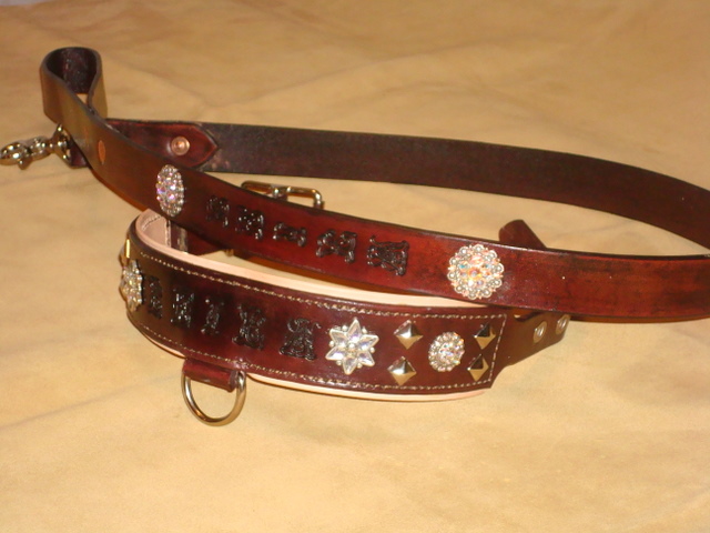

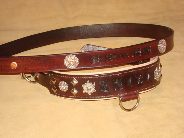

  4. You are welcome. I think it was Tan, I used Eco-Flo Gel Antique with two coats of Resolene sealer mixed 50/50 with water. The antique will be much darker in the impressions if you put it on heavy and then wipe off excess on smooth areas. Good luck, experiment on some scraps. Mark
  5. Yes, I leave it under the slab a few hours to get a good crease but it will still be damp when you remove it, now place inside collar and wrap both around something like a roll of duct tape to get a nice curved shape to both pieces. When all is dry start the gluing process.

  7. It is veg tan thin leather that I wet and fold over both sides so they meet in the miidle on the back side, put a nice crease in the edge and put it under my granite slab for a while. Then open up the flaps and put some glue between the layers and also glue to the back of the collar then sew. Make sure you form the inside piece to the collar when it is damp and roll the two pieces while gluing so you don't get any puckers and it will want to stay in that curved shape, I usually put a roll of duct tape inside of the two before gluing while the moisture dries to give it a nice radius. I leave it natural so no dye rubs off on the dogs fur and treat it with mink oil. So if the collar is 1 3/4" wide I cut the back piece 4" wide so there is a little overlap. I have more collars on my blog if you would like more examples, www.bentleyleathergoods.blogspot.com

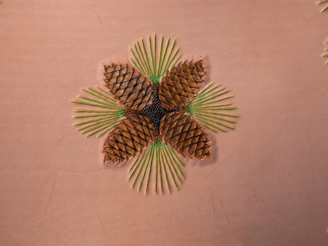

  23. Very nice, try using a Pro Petal tool to lift the tips of the pieces in the pine cone.
