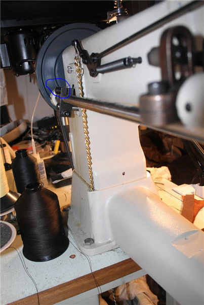

These explorations may be useful for others, but please don't try any of these adjustments unless we are all sure of what we are doing. I'm simply offering myself as a guinea pig. If it all works out, our little community will have the best 441 resource on the net, if it doesn't already. Please remember that anything I post regarding these adjustments is not necessarily correct and accurate but simply my best educated guesses. This post concerns itself with the amount of to and fro travel of the inner presser foot of the 441: I should have taken detailed pictures and notes before I adjusted anything. What prompted me to adjust this amount of to and fro travel is that with my new rt and lt side presser feet and inner groover foot, there was at least a half inch minimum distance between the inside edge of the outer foot and the outer edge of the inner foot (see pic) The attached pic shows post-adjustment when I narrowed that gap to a more acceptable 1/8". I was having some difficulty with skipped stitches with my raised needle plates and running without lower needle guide. The other day I replaced the lower needle guide and saw better stitches. However I also noticed that the the needle now ever so slightly grazes the front oval of the cutout in the needle guide, I believe because I had adjusted the to/fro travel of the inner foot, which also moves the needle bar the same distance. Now I must readjust that to and fro/travel, maybe 1/16" away from the front cutout oval of the needle guide. If memory serves correctly, I believe prior to any adjustments, the needle was centered in that cut out oval of the needle guide. That centering of the needle prompted me to wonder what if anything does that needle guide serve, if the needle is always centered in the cutout. I think I'm seeing better stitches when the needle is a bit more toward the front of that cutout but nottouching any metal of the needle guide. I believe the following is correct, but let's wait upon confirmed feedback from those with tried and trued experience and knowledge to be completely sure. Please note that this adjustment is for a feed-dog-less flat needle plate with a needle guide that has an oval cutout for the needle. Needle guides from Ferdco and Artisan may have a larger cutout for the needle to enter. 1. suspend the presser feet with the hand lift. 2. rotate the balance wheel so that the inner foot moves to its farthes forward point. 3. Rotate the balance wheel more until the needle has just entered the coutout in the needle guide. In may case, this means that the needle is ever so slightly grazing the front of that cutout, so I must make a small adjustment to move that needle about 1/16" back off that edge of the needle guide cutout. 4. Now you need to loosen the top allen head bolt in the vicinity of the balance wheel. This top bolt loosens the clamp on that thick bar running along the back of the machine. 5. Once loosened, you can now move the inner foot freely in its to and fro travel. Position the inner foot as required and retighten that allen head bolt. If I am incorrect in any of this, or ignorant of anything else I may have altered on the machine, someone please correct me. Ed

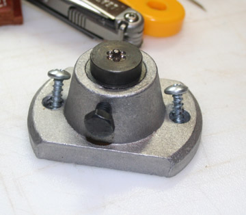

I've needed to find a more efficient way to set my tubular rivets, so I splurged on this benchtop die holder from OTB, $30. This would be a nice little product for someone to manufacture. I bet the actual die holder can be bought prefacricated. Then all that would have to be done is to machine the steel insert to the specified diameter. ed

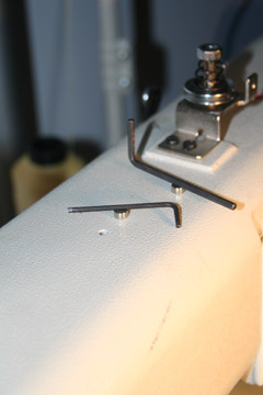

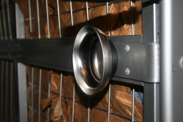

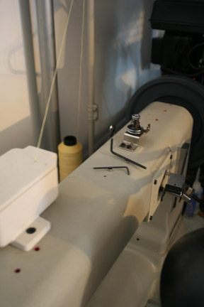

Steven King once wrote that he has typewriters all over the house, so if he gets an idea he can immediately sit down and start writing. I did a similar sort of thing with these magnets and magnetic bowls. They are placed all over the place so I can get to work in any space and keep track of needles, screws, tools, and such. HEre are some pics.

This may seem necessary, but I'm worried about using one of the bowls on my heavy stitcher head. I just imagine that over time the magnetic pull might cause problems with the timing. I do use a few 3/16" by 1/8" magnetic discs on the head to hold small allen wrenches, screws, needles, etc. ed
